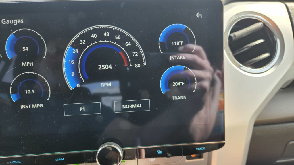

    Thanks in advance, been tracking my temps and generally 190-220 F most days without hauling.

    For me, I've seen temps in excess of 230 while ambient temps were under 60 degrees and while NOT towing (minimal weight in the bed) during a short but steep climb on asphalt in my '21.

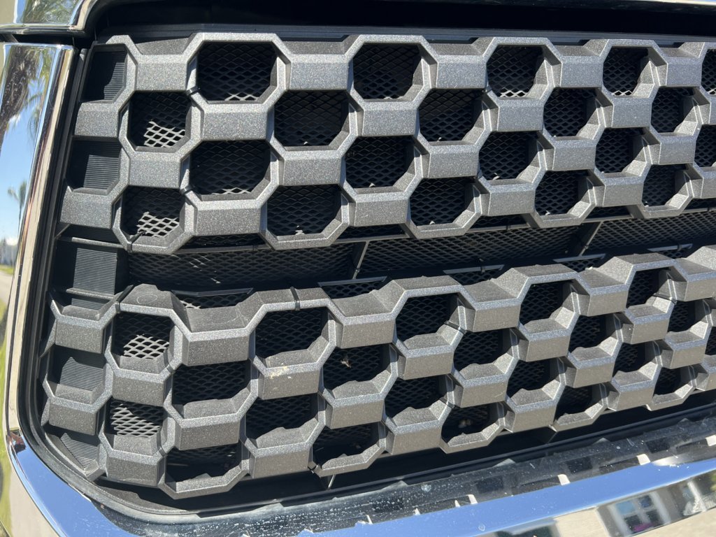

    A rock can hit your external fluid cooler causing a leak and you wouldn't know the fluid level was going down untill the transmission damage was done.

    If you’re worried about that use a screen behind your grill.

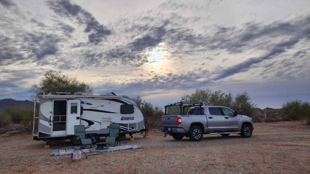

    My TT is 5,500 lbs. loaded (fairly light) but has a large frontal surface area (big parachute) and I tow at 62-65 MPH in S4 & Tow/Haul.
    On the flats through the desert with ambient temps in the mid to high 80's she settles in at 210-212º and climbing grades it'll spike and then cool off nicely right away when I crest the grade.
    Usually 225º-ish on the climbs, highest spike I've seen was 239º pushing it hard on a steep twisty 2-lane climb out of the desert from Imperial County into San Diego County.
    You don't dare get out of line into the right lane 'cuz you might never get back over.
    I pay close attention to TC lockup, and I'll slow on little rises to stay locked up when I can, &/or manually downshift.
    If I towed heavy or more often I might add a cooler, but for now I'm good with monitoring temps and doing drain/fills every 30K.

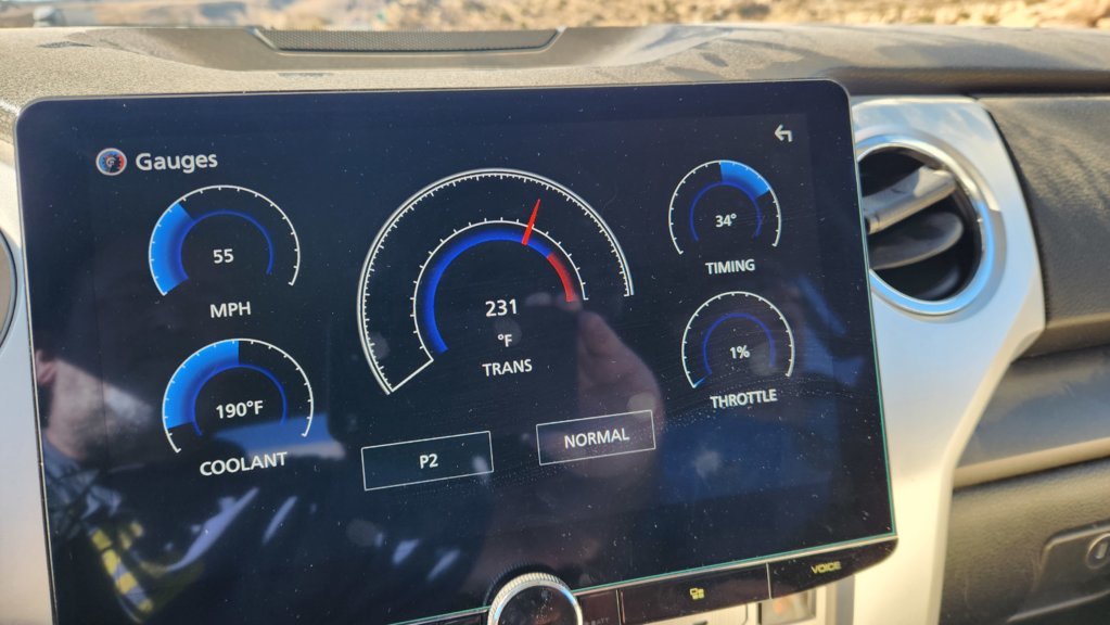

    231 is pushing it and there are only 2 ticks left til red - I like keeping things no higher than 200. With a cooler and fan mine achieves 170 at 80mph during 105 high humidity weather. Peaks (repeated stop/go reaching only 30 each time) in the same conditions just reach 200 and then drop fast once at cruising speeds.
    Read thru posts a setup can be DIY for very little - the least being the Africa setup where no thermostat is used - just straight piping in/out to the cooler - this is using OEM parts. Or if in colder climates a thermostat would probably be healthier for the trans to warm up its fluid faster. Luck all.
