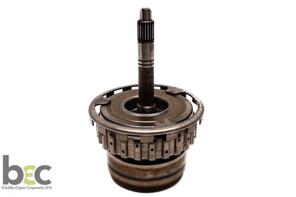

    From what I’ve been able to determine, the reluctor wheel for the turbine speed sensor on the A340 transmission is attached to the O.D. planetary set up front, and looks like this.
    The 16 tooth ring around the top of the planetary that appears to be spot welded on in 3 places.
    There are a few possibilities for why it’s attacking the sensor.
    -Bearing or bushing play allowing the whole thing to move off of center.
    -debris floating around getting stirred up by the reluctor wheel
    -broken spot weld(s) attaching the reluctor wheel, so it’s no longer centered.
    In any case, unfortunately, a transmission swap or disassembly for rebuild is in your near future.

    Thank you, I just saw all these replies. I think you hit the nail on the head. The bearing was my guess the more I looked into it, but either of the other scenarios could easily cause similar issues. Thank you for the picture It really helps with the visualization of it. I mean I knew it was going to come down to at least the transmission dropping. This part alone from Toyota I believe was about $730 so I believe having the transmission replaces with an 03' and up is probably the best solution. I really appreciate your in depth analysis. Funding will be the difficult part, but at least it's motivation to get my camry smogged and registered now.
