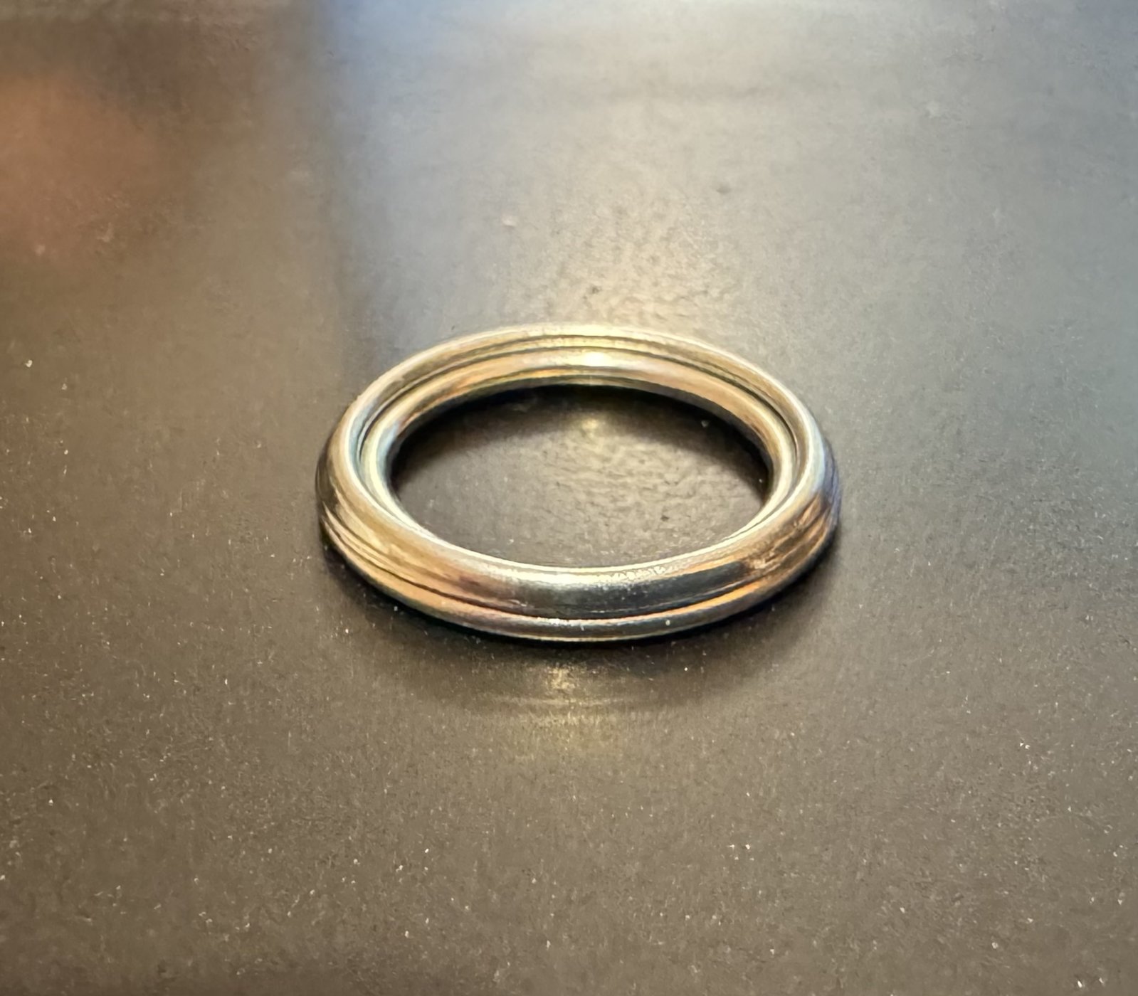

    Dealer-provided metal gaskets for drain and fill plugs; requesting info on proper orientation.
    See photo; the gasket has a smaller OD on one mating surface vs the other mating surface.
    Narrow side next to the plug, wider & flatter side to the transmission?
    Thanks.
    IMG_3660.jpg Dealer-provided metal gaskets for drain and fill plugs; requesting info on proper orientation.

    Pretty sure it doesn't really matter because it gets crushed anyways, but I usually do what you suggest with the larger OD toward the pan.

    This. The gasket gets crushed when you tighten the bolt.

    Taking off the factory-installed plug shows they install the flat surface against the plug, the other (narrower) surface next to the pan.

    I put the smooth side facing the bolt because this is how both came off from the factory. The pic on 1st post would gave the bolt come through the bottom and the washer would go against the pan just like the picture. Top of picture against the pan. So I say opposite as what OP posted.
    Crush washers should be replaced each time. The oring on the fill plug is most likely alright if it looks good.

    Specifically, I'm liking the flat side against the bolt portion, since that's how mine came out, too. The o-ring, I'm a big believer in doing you, but if you happen to care, you're already this far for an extra $1.25 for an o-ring. Again, do you.

    If I remember correctly, the flat side goes to the bolt head. Round (crush) side to the pan.
    In all honesty, it’ll likely work either way though. Put it on and torque till the bolt spins freely.

    I’m almost certain I put the crush washer backwards from the original orientation of the old one on mine and zero leaks. I doubt it matters.
