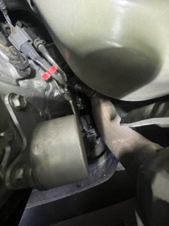

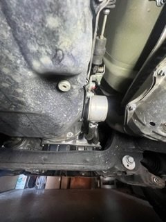

    I’ve been watching a lot of videos on how to do a transmission drain and fill. Every videos show that 2018 and up you have to bypass the transmission cooler thermostat. I have a 2019 SR5 4x4 and I can’t find one. Mine looks different. What am I missing?IMG_4081.jpgIMG_4081.jpgIMG_4080.jpg

    I believe starting in model year 2019, Toyota eliminated the transmission cooler on the Tundra… therefore, no thermostat to bypass. Not a favorable design change imo, but hey what do I know.
    TFL truck ran an Ike gauntlet with a late model 2nd gen without the trans cooler to test temps, etc… but I digress.
    Point is, you’re not missing anything, because your truck likely doesn’t have a thermostat to bypass.
