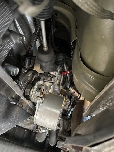

    Pinned open...

    When in doubt, pin it. It’s kinda like “when in doubt, throttle out.” Good advice, really.

    I had it pinned open when I installed a trans cooler and did a drain and fill. I took out the pin after the fluid level check was done.

    Pin in during the warm up and check procedure, pin out once you’re done
    or maybe you want to leave it in if you’re s/c’ed or tow a lot
