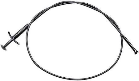

  4. May 18, 2024 at 5:32 AM
    bfunke
    bfunke Tundra Curmudgeon
    Oct 13, 2019
    #37321
    2,410
    South Carolina
    2018 SR-5 CM 5.7, 2000 SR-5 AC 4.7L
  5. May 18, 2024 at 6:12 AM
    FirstGenVol
    Dec 13, 2018
    #22934
    14,152
    East TN
    2002 AC TRD 4x4 V8
    What is that?
  6. May 18, 2024 at 6:15 AM
    bfunke
    Oct 13, 2019
    #37321
    2,410
    South Carolina
    Flexible grabber tool
