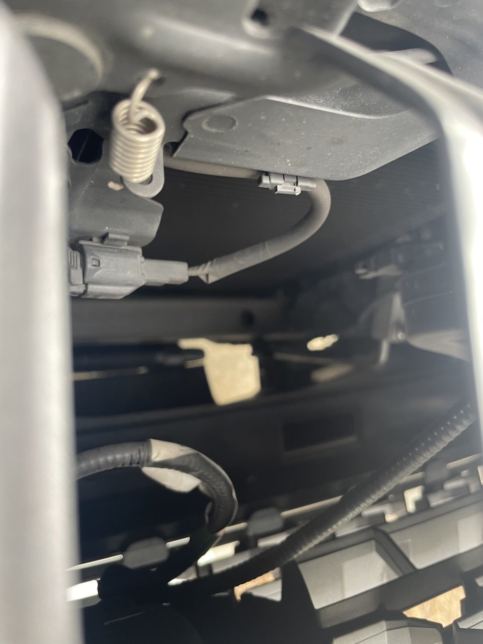

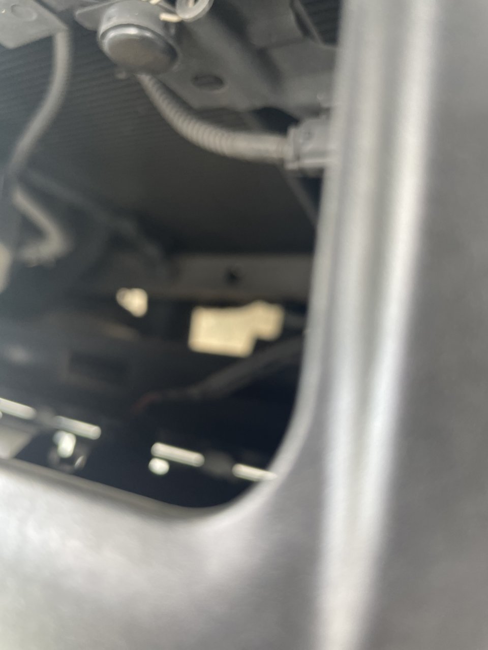

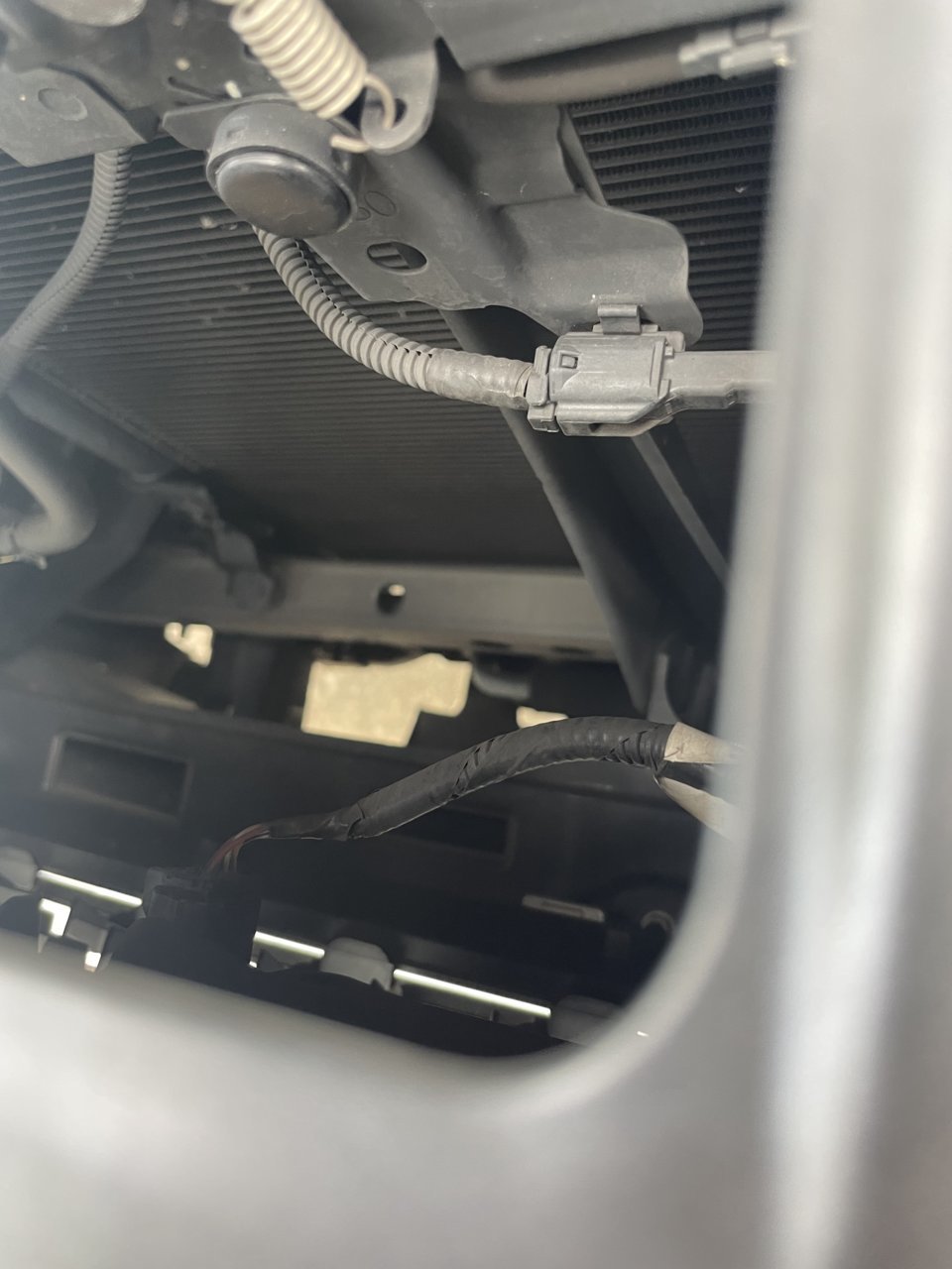

  5. May 27, 2022 at 8:23 AM
    Npowers66
    Npowers66 [OP] New Member
    Sep 19, 2021
    #68255
    70
    Nick
    18 SR5 crew max
  6. May 27, 2022 at 8:26 AM
    Moe2o4
    Moe2o4 New Member
    Nov 8, 2021
    #70424
    267
    Corey
    2020 Tundra SR5 Extended Cab TRD Offroad Package 8ft. Bed
    Bilsten 6112's with 2.5" Front Lift w/Bilstein 5160 Rear Shocks
    Well by those pics it doesn't look like its there. Should be on the left side of the grill.....
  7. May 27, 2022 at 8:28 AM
    Npowers66
    Sep 19, 2021
    #68255
    70
    Nick
    18 SR5 crew max
    That’s what I that. It’s an sr5 with tow package I thought.

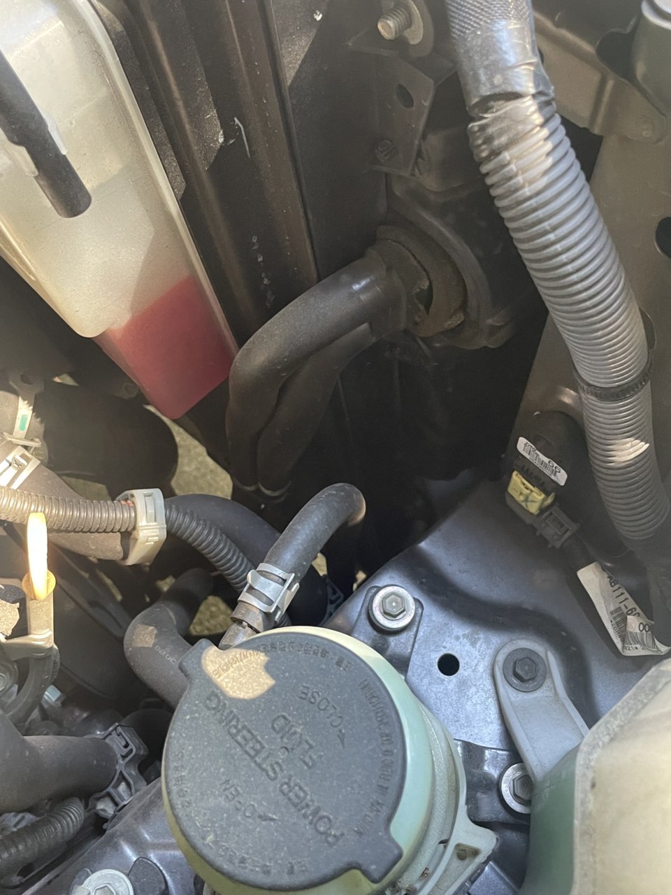

    You could always check to see if you have coolant lines running from the right side of the transmission to the front of the vehicle. Rather than looking for the radiator.
  11. May 29, 2022 at 6:53 AM
    Npowers66
    Sep 19, 2021
    #68255
    70
    Nick
    18 SR5 crew max
    these lines ?

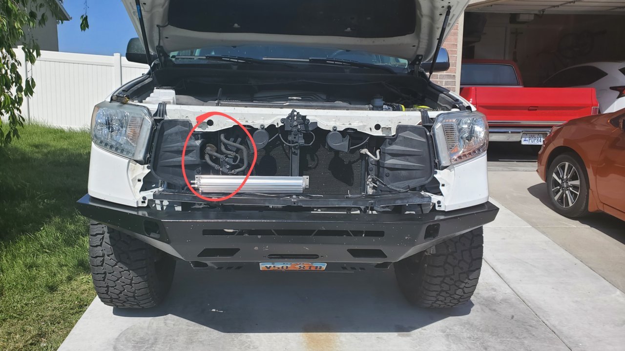

  12. May 29, 2022 at 6:56 AM
    Wahayes
    Wahayes Older I get the wiser I realize my dad was
    Sep 23, 2019
    #36539
    1,745
    Will
    2017 tundra limited
    325/60r20 falken at3w, 2.25 dobinsons ,20x9 +20 fuel torque wheels, leer xr100, bmc
  13. May 30, 2022 at 6:01 AM
    Npowers66
    Sep 19, 2021
    #68255
    70
    Nick
    18 SR5 crew max
    Well mine doesn't look like that. So I guess mine doesn't have the cooler….? Even tho the specs under my vin say I have the tow package.
  14. May 30, 2022 at 8:03 AM
    Wahayes
    Sep 23, 2019
    #36539
    1,745
    Will
    2017 tundra limited
    So in this pic ignore the silver thing, that's an aftermarket heat exchanger I'm adding for the power steering to replace the oem cooler. The black hoses coming out circled are for the tranny cooler. If you don't have that, sounds like you are sans Trans cooler
  15. May 31, 2022 at 7:44 AM
    68rs75z28
    68rs75z28 New Member
    Sep 8, 2021
    #67798
    170
    2020 tundra sr5 dc
    Yes those should be them.
