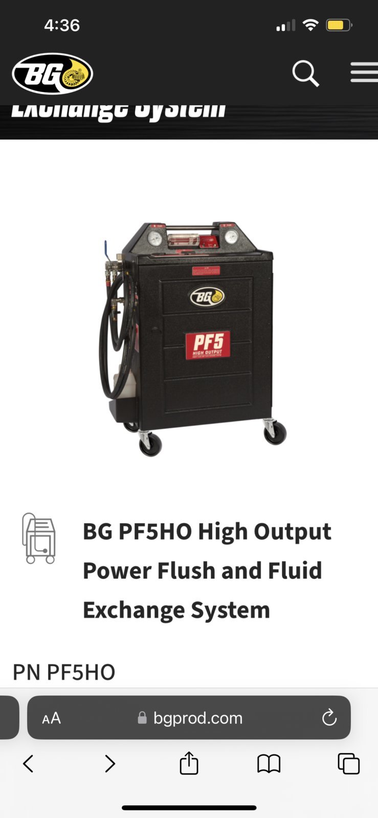

    Well, well, well…like clockwork, here comes the D&F club. Notice the flushing catastrophes always happen to someone’s cousin, a brothers friend, a co-worker, the guy that works at 7-11.
    Ask yourself this, my friend. Do you change only a 1/3 of your motor oil? Brush 1/2 your teeth? Wipe part of your $&@ after going #2?
    Safe and effective flush gets you this:
    “Drain and fill”, well …..

    Music City
    6UR-FE
    At 120k with original transmission fluid, I WOULD NOT flush it, @2011Tundra200thousandkm. A full flush is done under pressure. This can be a strain on seals and leave behind solvents. It can also cause media to get stuck. Brand new fluid plus any solvents left behind is a recipe for slippage in higher mileage vehicles. At 120k on original fluid, you’ve got clutch packs that are potentially showing a bit of wear and actually need some of the dirt in the older fluid to hold onto.
    My 4Runner (as in mine, not my cousin’s or my brother’s 2nd wife’s yoga teacher’s husband’s) started slipping at 130k miles when trying to shift into 5th gear (it has a 5 speed transmission…4 gears like our Tundras except only 1 OD gear). CURIOUSLY ENOUGH, it happened after a full pressurized flush by a Toyota dealership in Nashville.
    The analogy to engine oil doesn’t work because transmission fluid and engine oil play different roles. Not even going to go there with your teeth and your ass…
    Your engine oil is not forced through an impeller into a torque converter (read: fluid coupler) which causes a turbine to spin. Also, when you fully change your engine oil, it is not flushed under high pressure in an attempt to clean the varnish off the internals of the engine.
