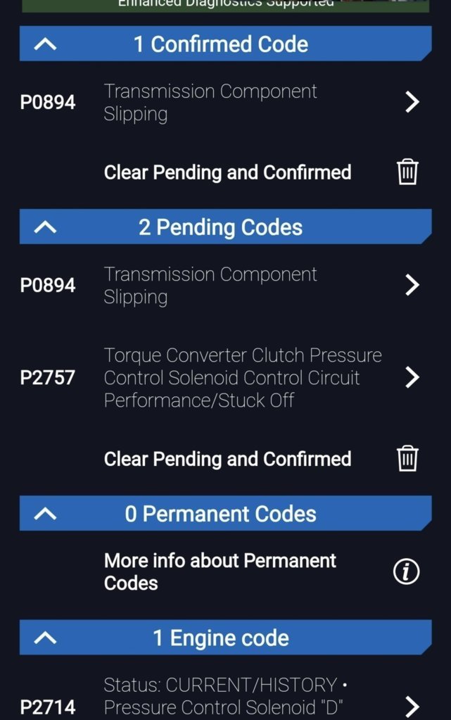

    I have a 2011 Toyota tundra I having problems with the transmission I take to the shop to rebuild and am still getting the same codes p0894 and p2757 the change everything like gears and the converter but keep getting those code any help

    They rebuilt the entire transmission? Did they change out the valve body and solenoids?

    They change valve body like 2 times and silenoid “d”

    I talked to a couple of transmission shops and they all stated these transmissions do not like to be rebuilt. It may be a local problem since I'm in the high desert, but correct me of I'm wrong but p2757 is solenoid C. D is 2894, I've replaced both and 2 additional ones and I only get the 0894, slipage when I overheat the transmission or fluid gets old.
    Edit:
    Its actually p2714, but p2757 is the torque convertor pressor solenoid. It's on the other side of the transmission. If you got charged for D solenoids, you got robbed

    Not sure on the p0894, try adding an extra quart of atf. The pan can accommodate it. Sometimes it can be low even when doing the correct procedure.
    The p2757 is a problem with a lot of top rebuilds. It's hit and miss with it not appearing. Sometimes the trans is fine but will set the code. Limit the trans to 3rd gear and see if it appears. Flex lock can cause it. Sometime the torque converter needs to be new OEM stock.
    Also input output speed sensors? Cheap and easy to do.
