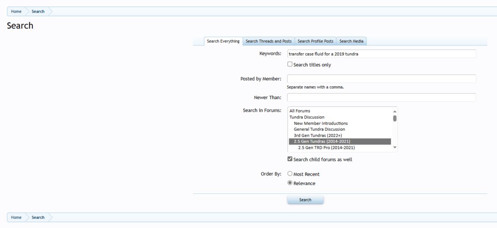

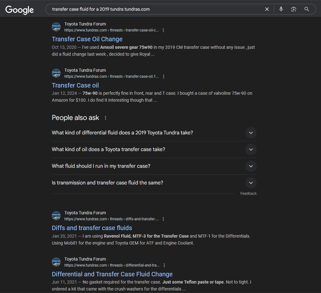

    Thanks for that . Im a young old guy so tec is not my thing . what and where did you look for that thread? Still hard to pick what oil to use but its a start. thanks again
  4. May 22, 2025 at 6:22 AM
    The Black Mamba
    The Black Mamba Black Sneks Matter
    Sep 6, 2023
    #103472
    4,234
    Ryan
    DFW
    Black 00 SR5 AC 5VZ PreRunner
    Imma keep it stock
    The search tab at the top right corner. Some find the search function here not the easiest to use, so what you can do is go to google, type what you want and then add tundras.com. It's really good at pulling the best info from this forum first.
