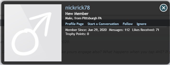

    Interesting. Now it's showing you haven't been here - maybe it's your privacy settings on the forum:
