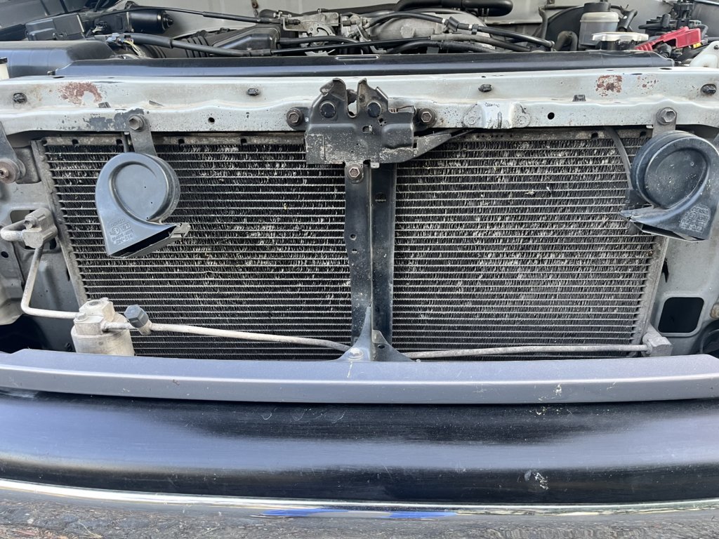

    When I went to take a picture of the radiator I found a date code 2/2014 so the radiator has been replaced. I was thinking that adding a fan might make a difference because the temps shoot up so much during these forward/reverse hill climbs under 5mph, but I’m certainly no expert. I’m willing to put in the stock trans cooler from the V8 if you guys think it’s the best option. Here’s the picture of the radiator:IMG_2551.jpg

    You got this. All day. Plenty of room. Very common mod for the 5vz with auto trans.
    (Same trans as the 00-04 V8)
    Trans cooler with an e-fan on it would be a great mod. Either set the fan to come on when the fluid hits a certain temp or wire it to a switch and monitor it yourself, engage fan yourself.

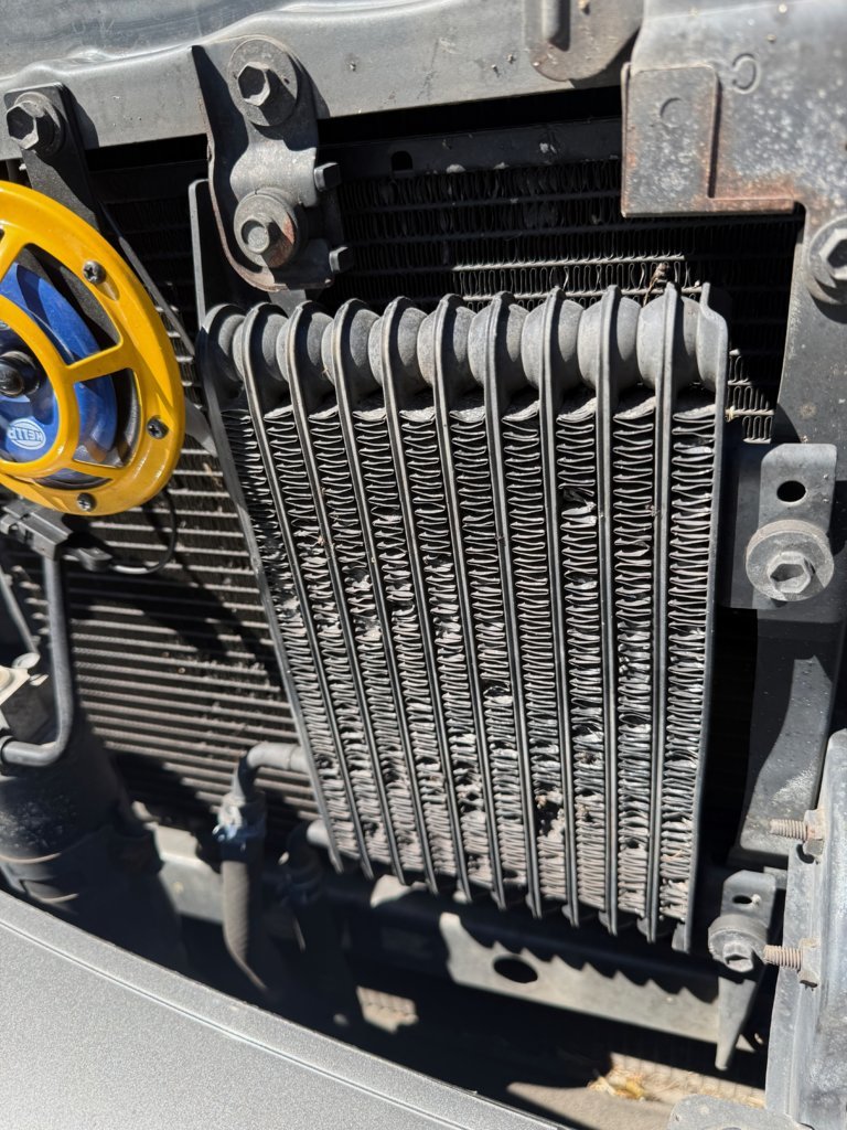

    Stealing from @Upshot Knothole so you can see where it is, how it's mounted up. You have all the notches and holes, you just need to find a donor. Ignore the yellow & blue Hellas, some people are just hornier than others.
    Upshot Knothole and BroHon like this.

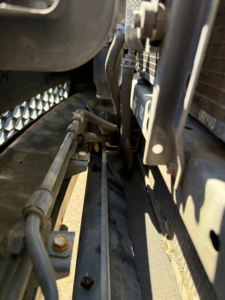

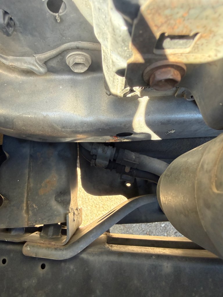

    Here's a few more photos of the trans cooler. Bolts to the center support and both lines run down around the passenger side of the bottom of the radiator.
