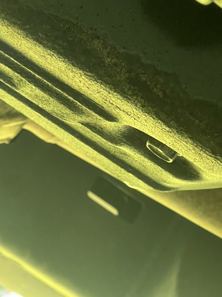

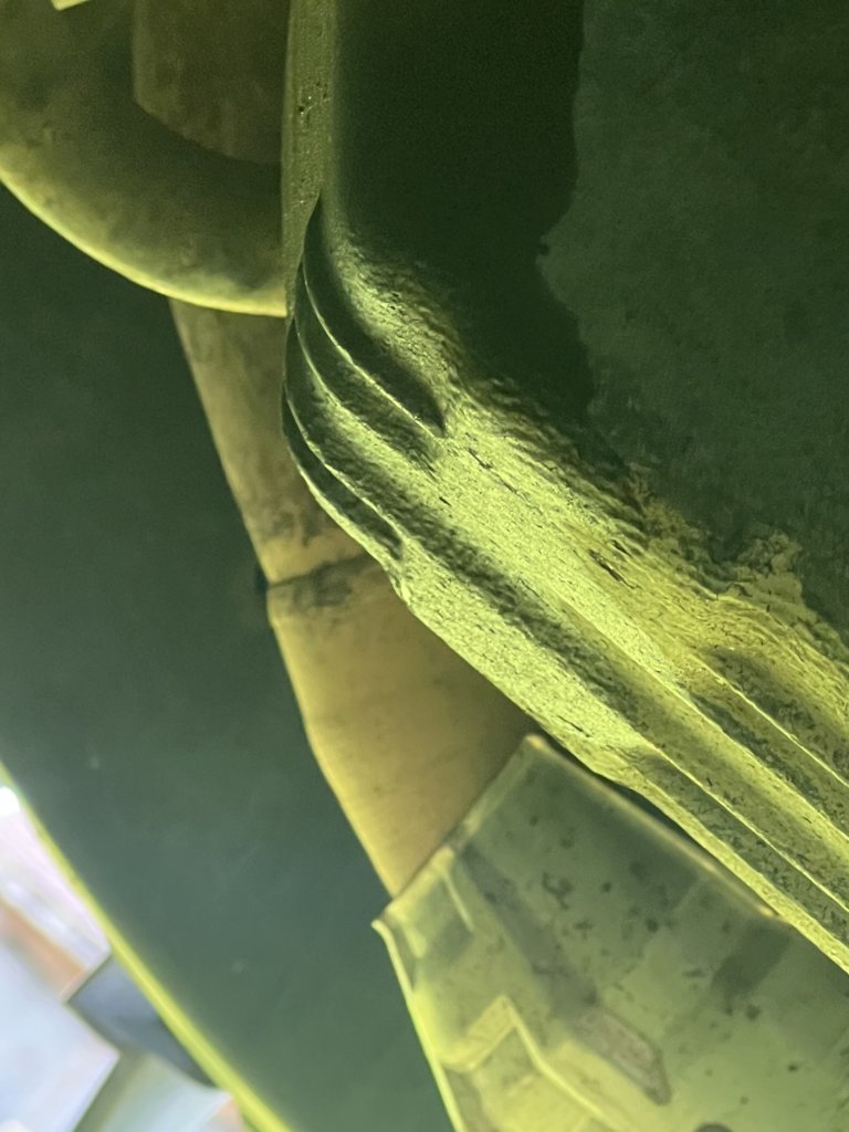

    I have a trans pan leak that I discovered the other day while underneath the truck. I saw a wet area in the pan. Fluid looked darkish red. I’m having the dealer replace the pan, gasket and replenish fluid. Should I also get the strainer/screen replaced?

    Not necessary. It should last a lifetime in an aisin trans. I would however examine what is in the bottom of the pan . If there is a lot of debris, then I would change the filter. However, at that point the trans probably won’t live very long.

    Are you sure it's from the pan and not running down the side of trans cooler? It's just 2 little o rings in there sealing.

    Could also be one of the two crush washers. The moving air distributes the mess over the whole pan. Best to clean it well and let it sit overnight and then follow the trail

    Where would the trans cooler be located? I thought it was near the front where the radiator would be?? I noticed that the pan area was wet and couldn’t tell where it came from.

    Sorry I meant the thermostat for the trans. It's on passenger side of tranny right behind the round puck thing.

    Upon further investigation, they’re saying that there is a leak from the front pump seal. They traced the leak and said they saw red fluid where the trans meets the engine. They’re recommending whole trans replacement rather than replacing the seal. It’s not actively leaking on the ground but the pan remains wet looking.

    One thing I can say for sure is those people at my local dealership are liars!!! The leak is actually coming from the output shaft seal and I also would need a seal for rear differential (which the dealer was suppose to have fixed months ago but apparently didn’t). This mobile mechanic will charge just $400 and that includes all the parts and fluid (he’s making sure to get WS fluid). Never will I ever take my truck to the dealership again! They had me thinking that I would have to get another trans soon. Front pump seal is not leaking…thank god.
