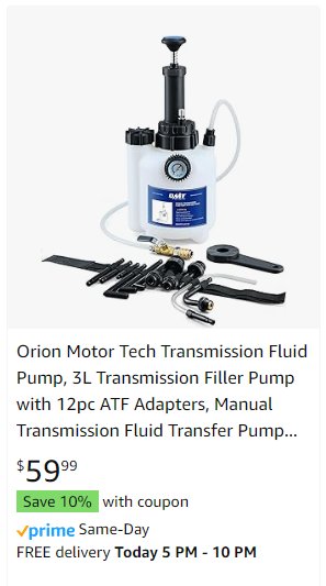

    1. Drain and fills are easier than an oil change.
    2. Valvoline MaxLife or Toyota WS, generally speaking, matters not. They are the same-ish WS=WS
    3. get something like this & it will be exponentially easier
    4. I have used Valvoline MaxLife for 60k miles now. the Transmission still transmits.
    5. do the drain & fill, usual 4qts, every 30k miles.
    6. Get a Supercharger.
