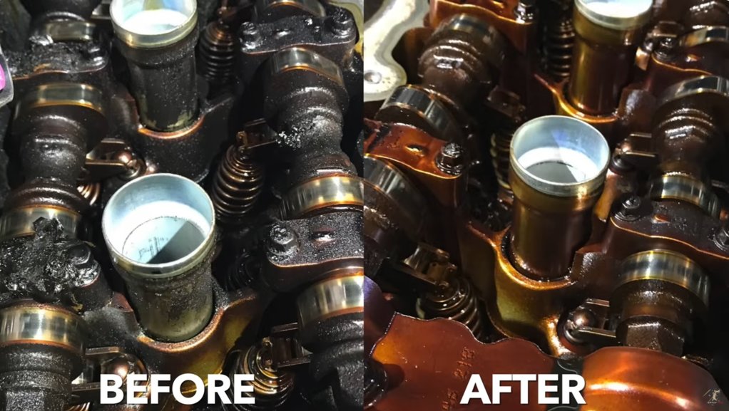

    Quite a few of the products have been reviewed online and proven to . Like the Dynamic Engine Restoration product. Here's one of those videos from a popular, non-shill, not-sponsored-by-BG automotive channel. He actually did two of these, a Dodge Neon and a Camaro. Screencap from the Camaro follows, and both videos are below. Honestly? The BG Dynamic flush is not dissimilar to what my grandfather would do, running diesel in the crankcase of his vehicles and farm equipment to clean it out. But it's probably more gentle, and includes additives sensible for modern seals etc.
