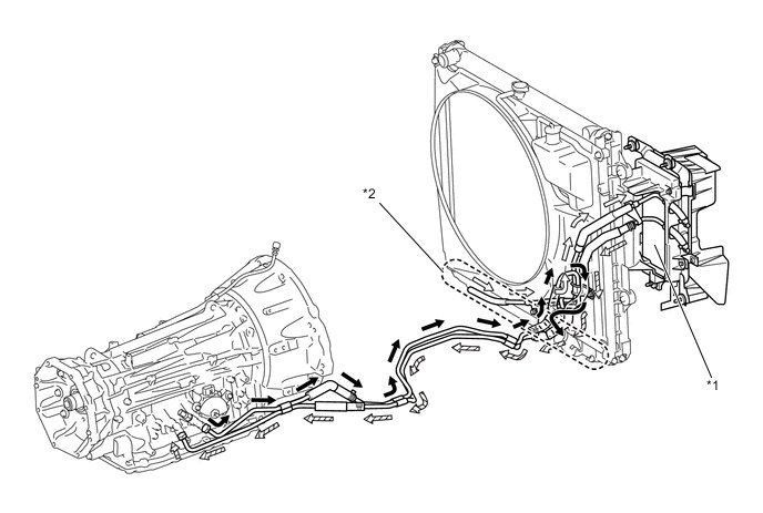

    Would a similar year, 2021, Lexus, tranny oil cooler be a direct bolt in for my ‘21? Obviously I’d need to either fab lines, or pick up a set of oem’s, I’m just curious if the cooler will physically bolt right in without having to fabricate and brackets. Thanks guys.
  2. Mar 8, 2024 at 5:03 AM
    Terndrerrr
    Terndrerrr 924000 miles to go
    Jul 8, 2019
    #32965
    6,134
    Music City
    6UR-FE
    What application was the Lexus cooler designed for? I would err on the side of larger is better if you’re installing it in a truck that will be doing heavy towing or hauling. Any aftermarket radiator up front will work if you fab up a bracket to hold it secure. I doubt the Lexus cooler’s mounts (assuming for an LX570?) will bolt right into behind the grille of the Tundra.
    The important part is to order the thermostat and hardlines from a 2018 Tundra. Aside from that, you only need hoses, clamps, radiator, and mounting bracket. Your truck has a thermostat-shaped plate to block the ports for the external cooler system where the 2018 OEM parts will bolt right in.

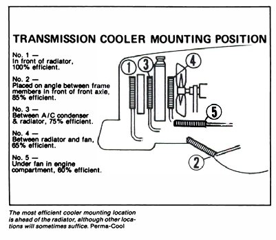

    Their kit with 15-row trans cooler is blocking half the radiator, how is that any good? the original trans cooler from toyota didn’t interfere with airflow to radiator like this one does?

    I have the 15-row, it’s not exactly half the radiator, I believe the 25-row is closer to that. Regardless, I tow all the time and have had zero issues with the coolant temperature or A/C condenser being affected.

    Given the distance from the backside of the cooler to the condenser I don’t think it’s an issue as there is a few inches. This creates plenty of air gap. Finding a good spot to mount the cooler where it gets decent airflow is pretty much always going to be competing for the same area as condenser and radiator.

    I have an OEM LC200/570 trans cooler that might be finding a home on my 2011. It probably won’t bolt in to any existing mounting points, but I’ll take a closer look asap. Unsure if the 2.5 radiator support is different enough to matter. The cooler is similar in size to the 2007 - 2010 side mounted Tundra trans cooler, which probably has a higher likelihood of fitting up. The side mount is better in that it doesn’t preheat any air prior to the ac condenser or radiator. The downside is that low speed driving doesn’t provide enough cooling air under higher loads. A small fan can solve that, along with other things.
    Saltyhero13 likes this.

    This is the original design of the system from the LC200. Most markets did not receive the thermostat or transmission mounted heater, that was a USA increase in efficiency part, though benefits are obvious for colder climates. Note the heat exchanger tank in the lower radiator, then the oil to air heat exchanger. Set up in this manner, low and high speed cooling requirements were covered.. pretty standard. Can improvements be made to this? Sure. Mounting the transmission cooler in front of other heat exchangers is just not desirable, even when spaced forward, it’s preheating a good chunk of air that headed for what is probably the most exposed (to cooling air stream) and thus efficient part of the condenser and radiator. My recollection is that the second half of any core does roughly 1/4 the work of the of the first half. Let that sink in, no pun intended.
