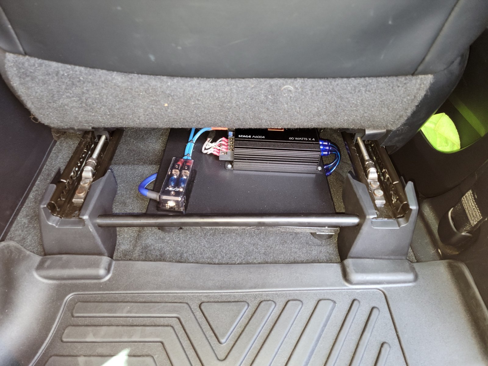

    When I upgraded my JBL sound system, replacing all but the HU, I ended up with more equipment under the driver and passenger front seats than I had planned for. Arranging it all so power cables, interconnects, speaker wires and controls were somewhat accessible without unbolting and tilting, but also protected, was an impossible task. Therefore, I schemed to implement some sort of barrier across the lower-rear of the front seats to protect from threatening toes riding in the backseats.
    Considering there are HVAC vents under the front seats, with airflow directed toward the rear, I installed all equipment on racks (fabricated from 1/2" HDPE cutting boards) that I elevated, using rubber feet, above the vents, so as not to block them. It was important to me that whatever barrier I came up with that it also not substantially interfere with airflow.

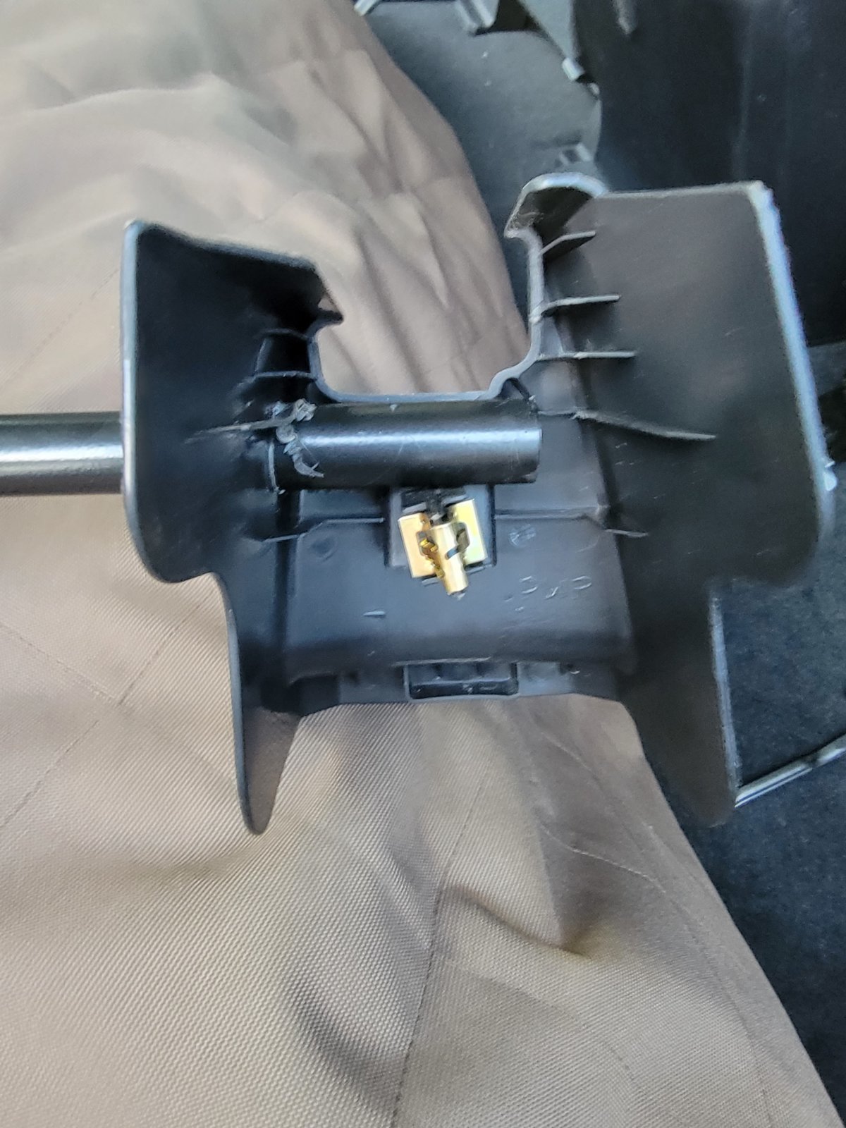

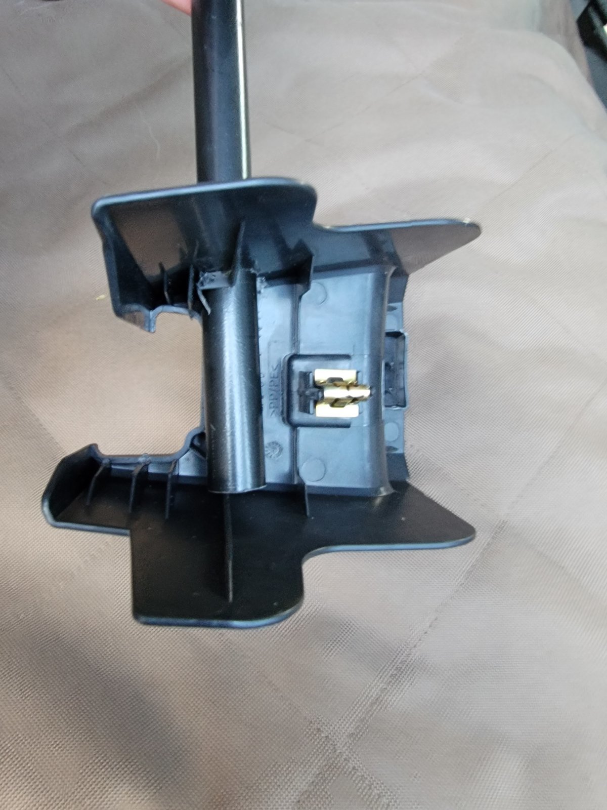

    I drilled holes, using a step bit. Hole placement is critical (measure ten times, drill once); the pipe must fit tight up against the bottom of the seat rails while still allowing the trim caps to snap securely back into place. 20220924_182309 (2).jpg

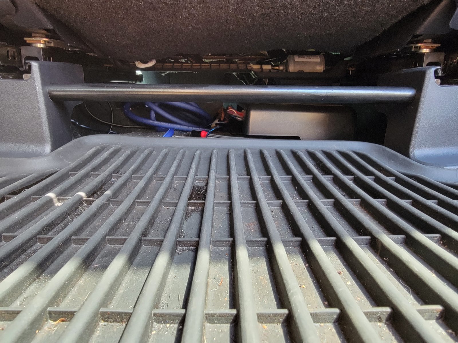

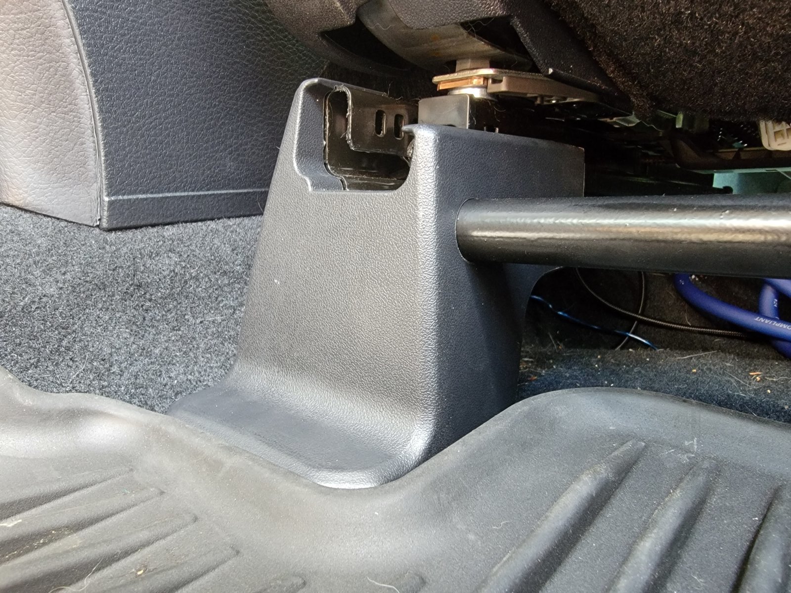

    Completed and installed, the trammels are solid, solid. They do not slide back and forth; they do not move. While sitting in the back seat I tested, kicked and stomped them, hard, while wearing work boots. They didn't budge. I've had them off several times, like when I added the line driver and ESP-3; easy as snapping the trim caps off and back on.
