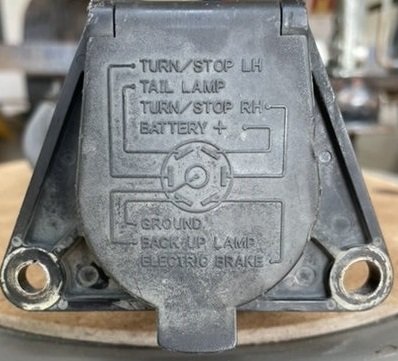

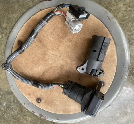

    Have mine off to paint and should be 7 connectors counting the center back up lamp if it’s tow package. The other item is a 7 to 4 pin plugin

    Ok, mine looks like 5he picture above. Is there a trailer running light fuse I can check?

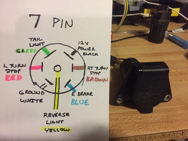

    The green(top left pin) if indeed like above pic, is your tail lamp. If you have a meter, turn lights on, should have 12 vdc at top left pin(green)

    I will check that. Thank you for nice diagram.
