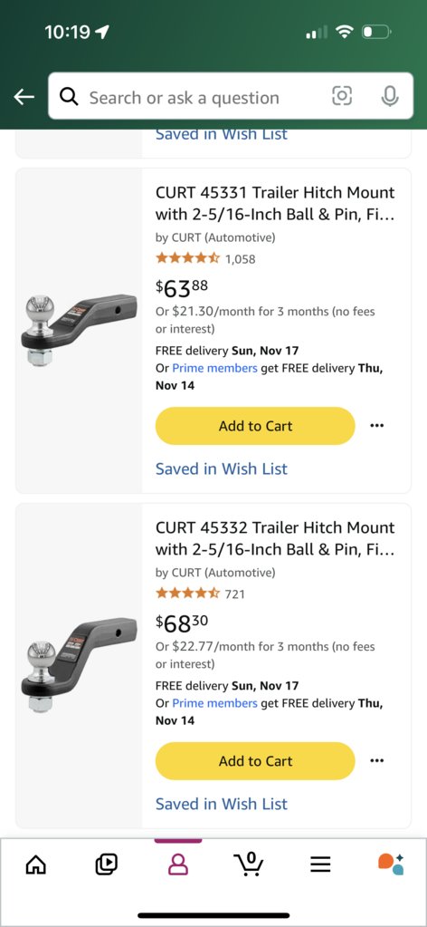

    If I just got one of these, which would work better for my tundra that has a 3.5” lift? On is a 2” drop and the other a 4” drop.

    When I first started towing I got a kit from etrailer, Curt I think, basically with both those hitches. Technically that gives you 4 height choices, if you're willing to do the work with giant wrenches to take the ball out and flip the hitch.
    That worked for me, but I really only tow one trailer, so I've only ever needed one of them.
    Problem with asking the forum "which works better for my truck?" is that the truck is only half the equation. I'll go out on a limb and say if you've got a 3.5" lift, that's pretty big, so the 4" drop is more likely to be the right one. But it depends on the trailer.
    Anyway I have no lift, and the 2" drop hitch has worked for me with the two trailers I've towed. 4" is too much for my stock height truck. I'd guess 2" isn't enough for your lifted truck. But...hard to say. Nowadays there are those jacked-up camper trailers that are probably the same height as your truck.

    OP asked about height. We can’t say since not all trailers are the same. My Tundra is lifted 3” front and 2” rear with 285/75R18 tires. I use 4” drop with my 5x10 utility trailer, and flat with my 20’ flatbed. In my experience, you’ll either have an adjustable ball mount or you’ll have a ball mount for each trailer.
