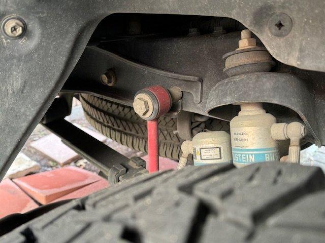

    I had to pull those when I installed my rear sway bar.
    It did take a little work to get them out.
