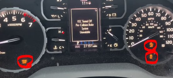

    Text loses a lot, so please don't think I'm being condescending or a jerk. I'm low on sleep so I am just trying to illustrate and clarify.
    For the Colorado bit, low speed off road should be 4lo to keep the transmission temps down. It sounds like if you had it in 4lo for that one you would have been ok to start with. 4lo fully disables things, so it handles the off road stuff better.
    Now, for the turning off of nannies. I've seen lots of threads and videos that tell you how to do this, and about half of them miss the last step. Just to make sure you've got all of it I'll type it out. I only do this because you didn't provide the info and I want to make sure you have all of it before modding/tuning to try and achieve something that you might just be missing one part of.
    For full nanny disengagement you have 3 button presses that must be done with the truck running and in park. You can't do this on the fly, and you have to do it every time you restart the truck.
    1. Truck running, in park, press the Traction Control button once. This will illuminate the Auto LSD dash light.

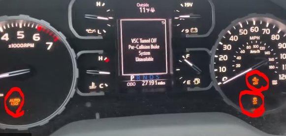

    2. Press and hold the Traction Control button until the Auto LSD, Collision avoidance, and Vehicle Stability Control (same icon as the Traction Control button) lights illuminate. The in dash screen will say VSC Turned Off, Pre-Collision Brake System Unavailable You'll be holding the button for approximately 5 seconds for this to occur.
      • This is where most people and many guides end stating "traction control is off", but there is a final step.
    3. Press and hold the Traction Control button again. This time it will illuminate the Pre-Collision Braking light, the VSC light, and the same "VSC Turned Off, Pre-Collision Brake System Unavailable" message will appear, but instead of the Auto LSD light being illuminated you will instead have TRAC Off light illuminated.
    After going through these steps it should allow full wheel spin for sand, mud, or snow. This is the best you can get without modding or tuning, and it should handle the scenarios you've presented while keeping your truck completely drivable for regular use.
