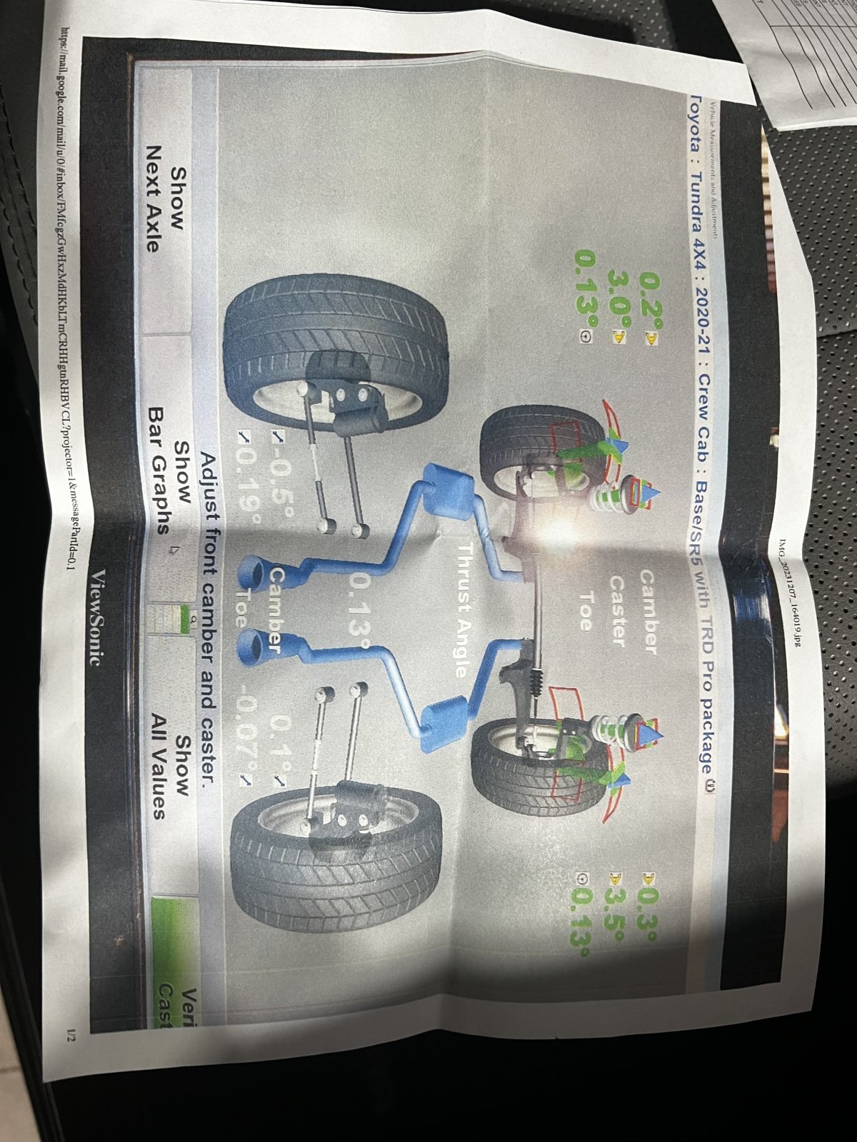

  20. Apr 29, 2024 at 7:04 PM
    HLR_NM
    HLR_NM New Member
    Aug 25, 2023
    #102765
    144
    Harry
    You lost me at Rough Country.
    Kidding aside, what are your alignment numbers? Do you have enough caster?
    If it's happening on downhill turns the truck may be getting confused by the front wheels spinning at different speeds out of normal range for the VSC. With bigger tires and insufficient caster the computer could possibly throw a fault.
    But this is just a guess. YRMV.
  21. Apr 29, 2024 at 9:49 PM
    LunarRockAgave
    LunarRockAgave New Member
    Feb 4, 2024
    #111474
    19
    LimitedCrewMaxLunarRock24
    That's what I'm guessing for mine. I have some positive camber, as I didn't upgrade the UCA's yet. In the books to do next. I have the same issue as @DizzyZ (Sharp right with slight downhill).

  23. Apr 30, 2024 at 5:41 PM
    DizzyZ
    DizzyZ [OP] New Member
    Jan 9, 2024
    #109957
    10
    Dennis
    2024 Toyota Tundra Limited
    3.5" lift and 35" tires
    These Are the numbers from my alignment. I don't know if it will tell you anything or not, but I definitely appreciate the input!
