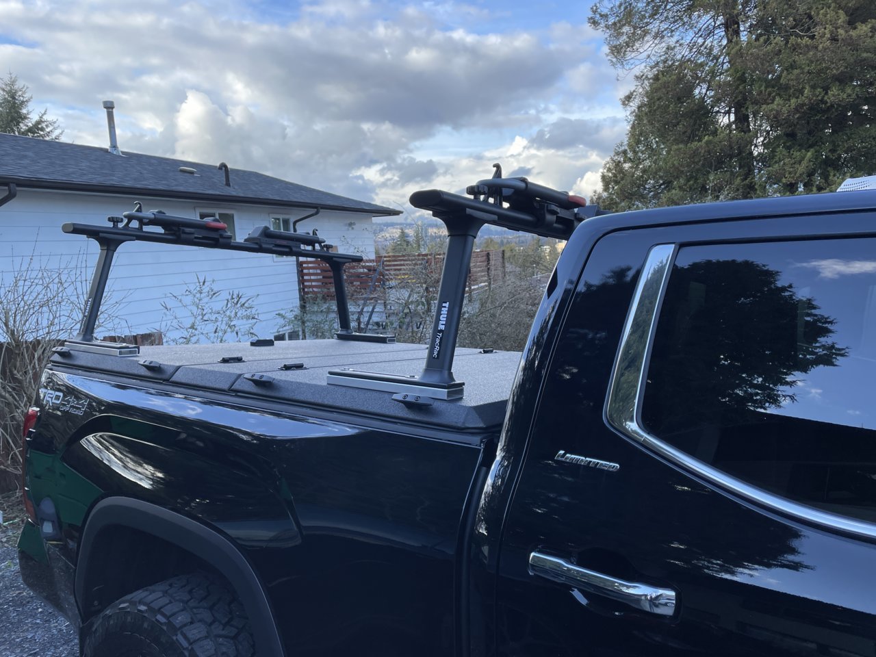

    I did the TracRac on my diamondback cover.
    The racks can be cut down and re-tapped to sit and the desired height. I have to cut mine down by about 8 inches.
    I sat the rack feet on 1" x 3" spacers that are mounted to the cover.

    Another view! Kayaks are 12' long

    I trimmed my TracRac to make it just higher than the roofline. Fits the truck much better now.
