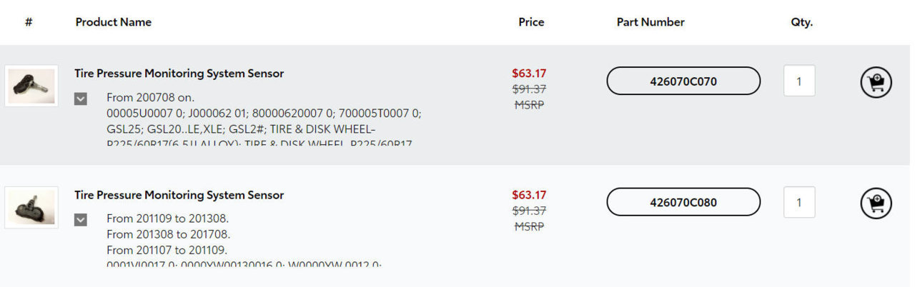

    Looks like you have the following TPMS sensors available for your 2017:
