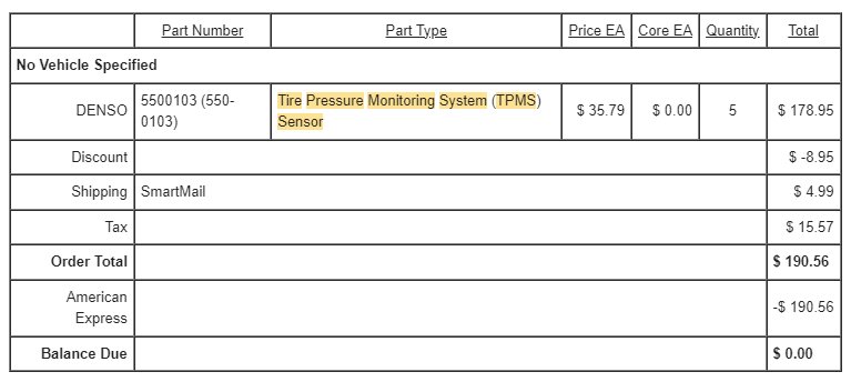

    Don't go with aftermarket. Too many horror stories on here about other people who did that and were fighting with occasional flashing TPMS light, and some opting to replace with Denso, so they paid as much as you would for OEM at the end of the day.
    Go to www.densoautoparts.com and look up their sensor part number. Denso is manufacturing the sensors for Toyota. Should be around $35/wheel. Don't forget the spare.
    You still need someone to program them in - i.e. replace the old wireless transmitter IDs in the TPMS ECU with the new IDs OR clone the old IDs to the new ones, I think is maybe an option? Special tool/scanner required for either.
    This was my last order for (5) sensors via RockAuto. DO NOT BUY from scAmazon or fleaBay. Order from RockAuto or Summit Racing to ensure you get authentic product.
