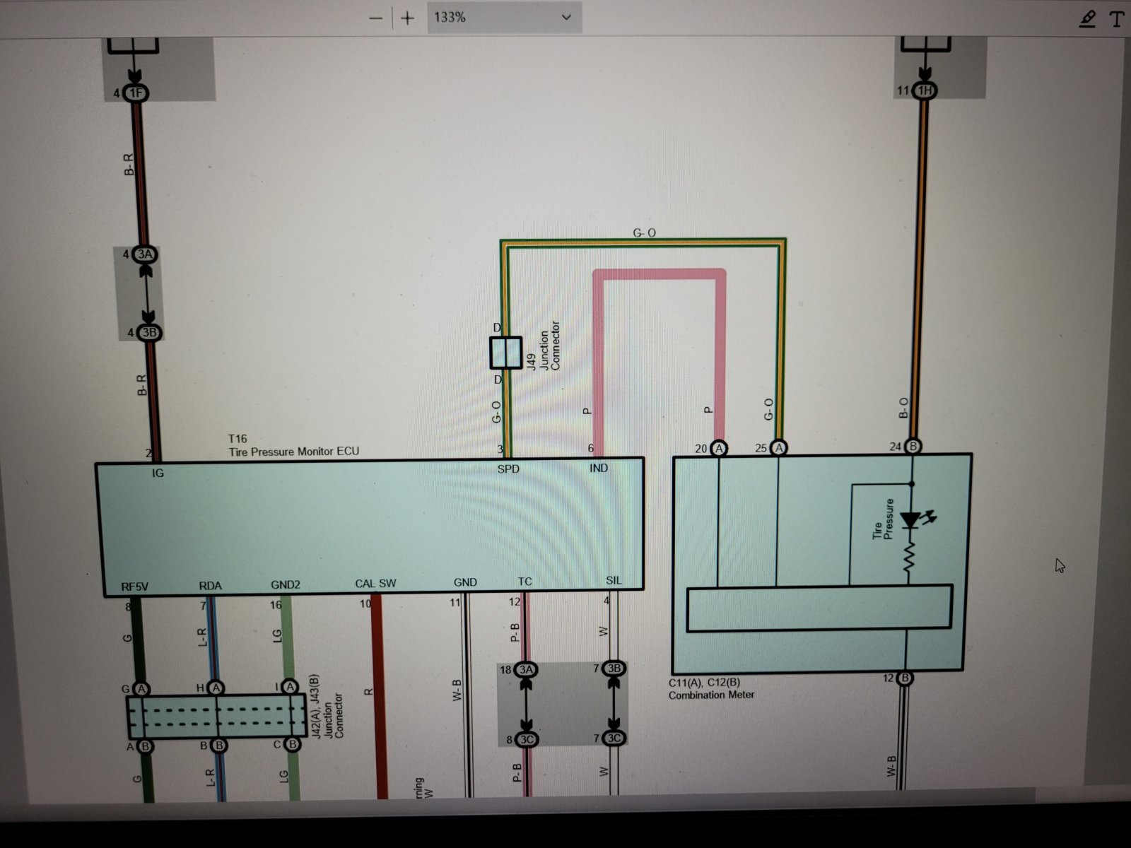

    It's been a few years since I did it to my '06 but I believe you ground out the pink wire. This is located behind the stereo as others have pointed out.
    This will disable the tire pressure warning light from turning on.

    here's the post i used for the TPMS light delete. worked on my 2017. not too difficult other than contorting yourself in the passenger footwell ;)
