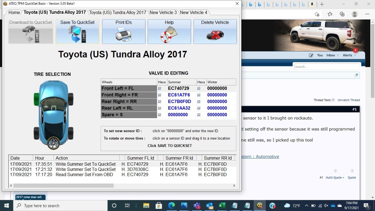

    purchased an additional trd rim because I wanted my spare to match, and added a new tpms sensor to it I brought on rockauto.
    Moved an older trd rim to a spare because it was a little beat up.
    So a little while later I was getting a tpms light. I figured it out that my spare was leaking and setting off the sensor because it was still programmed and leaking air . Had it swapped out to just a regular valve.
    Light still on so I Figure it must be that my new sensor id was not programmed and the old one still was, so I picked up this tool
    pulled out the bad sensor ID and added my new one in. Everything perfect now. great tool
