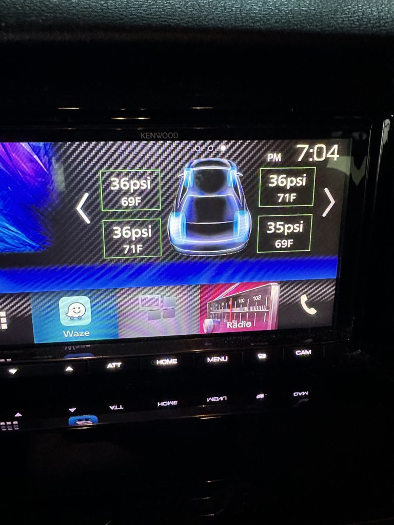

    I'M AN IDIOT!
    So i called idata earlier this week. Gave them the rundown about the TPMS not working. They said to order a 2k ohm 1/4w resistor and call them back when i have it to bridge the grey/red and yellow wire (dont quote me on this...check with them if someone else in the future is reading this). Amazon delivered it, and i called them. Service was super helpful and had me go into Settings->System->OEM SETUP->Maestro Settings.
    Now, i had gone in here before.....i remember that there were a few different settings i used when setting up the gauges....but all i see is "Camera Settings"
    AIL4fc8vHsogm9oQwKYtcP-Y2DqK1HxddCl7fIvw_3bc0fe37bc6f3fdd9a80c731a21d36712284a103.jpg
    I tell the support guy "all i see is Camera Settings....i remember seeing a lot of other settings previously".
    "it sounds like you are on the second page of the setting"
    "sonofamotherfuckingsonofabitch......it better not......ahhhhhhhhhhhhhhh"
    *chuckles* "press the up arrow and you'll see the Module Master Reset....that usually does it"
    AIL4fc8wSha890eYuhwMw9dG9LbpN25S17Fj6HmG_a92f72734d8913ae5a6a2b207871d1ffa892b1be.jpg
    So i press it and drive around the block, and its all back to normal. TPMS/Temp all correct.
    I have reset this stereo back to factory settings probably at least 3 times and it never occurred to me that its on the second page.
    Hopefully this helps someone.....or if anyone needs any 1/4w resistors in the Sacramento area, i'm your guy!
    GODZILLA and BravoDeltaRomeo like this.

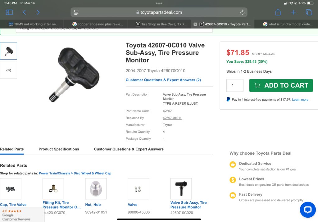

    In case someone has the same issue as i had. I have a 2020 1794. I replaced all 5 OEM wheels/tires/TPMS. When they installed the new TPMS sensors they enabled the re-learn function so my TPMS light blinked for 1 minute and turned to solid. It never showed me any pressure numbers. Kept saying re-calibration in process... For 3 months.
    Long story short, i found the fix 3 technicians could not. It was in the owners manual! See picture below. Basically you have to make sure Ignition is ON, engine not running. Press TPMS button 3 times a few times (aka press 3 times, wait 2 sec, press 3 times, wait 2 sec...) until TPMS light slowly blinks 3 times. When that happens, let tire guy use his tool to scan your truck/VIN, scan all installed TPMS sensor and load it back to the truck's computer. After this TPMS light went dark/off. 10 minutes into driving home all the PSI readings appeared on the dash.
