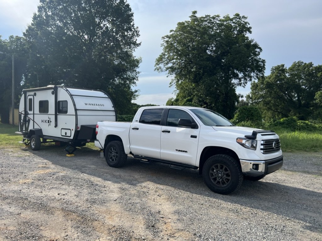

    Hi all. I towed my 4k lb travel trailer about 2k miles over the past two weeks and my '21 CrewMax SR5 towed it great. However, the TPMS would cut out after about 30 minutes of driving while connected to the trailer pretty much all week. Disconnected there were no issues. I have just put a 1.5 in block lift and RAS HD System before we left and that's really the only change I've made in the rear. Ideas of what it could be? I'd like to know my tire pressures while towing and it's frustrating for it to cut out so often while connected to the trailer.

    I had the front at 40 and the rear at 50. They are not OEM, I went with 34s in the Falken Wildpeak AT3 on the stock wheel. No problems when the 7-pin was disconnected and the pins are cleaned and greased. The trailer has it's own breaks controlled by the stock brake controller. There is no aftermarket camera on the trailer. I'm sure there is some sort of interference in the signal but I can't figure it out since the TPMS is a wireless system between the wheels and the sensor.
