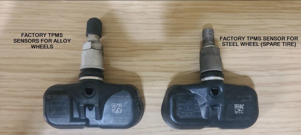

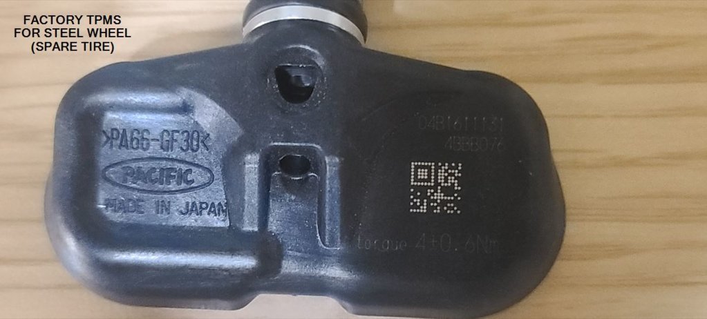

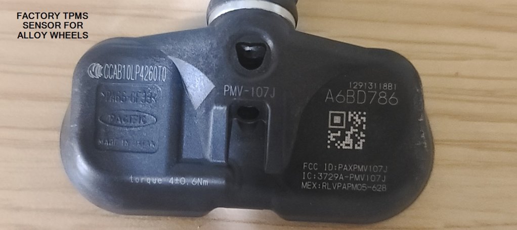

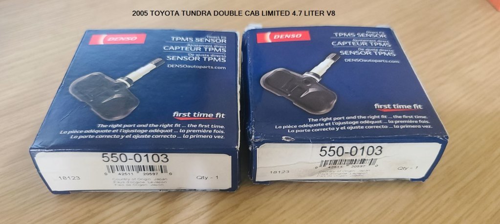

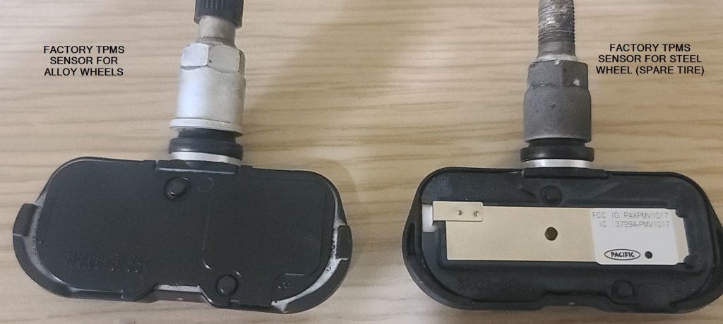

    This is my first post in this forum and I wanted to share that the information above for the TPMS sensors for the 2005 Tundra Double Cab Limited is the Denso 550-0103 for all 5 tires. I am the original owner of my 05 Tundra and just replaced my TPMS sensors for the second time. The first time I replaced the four alloy wheels with original Toyota TPMS however they were twice the price as the Denso which seem to be the same thing. I opted for the Denso and replaced them once again including the steel wheel spare tire. This was the first time however I replaced the spare tire TPMS (19 years) as I never knew it had a sensor as I never had a light on. What I found was that the spare tire sensor was never programmed to my vehicle. I now have 5 TPMS sensors programmed on my Tundra. I used my Kingbolen K10 OBD2 programmer to manually program the TPMS sensors to the vehicle. I used my Thinkcar TPMS G2 to read the sensors after they were installed inside the tires so I knew which sensor what in what position.

    Quick question, out of curiosity. Can the Thinkcar TPMS G2 program sensors (clone) without removing the sensor from the tire?
    I’m thinking ahead over here. I went to discount tire yesterday to get a 2nd set of wheels rubbered up. I had them install new TPMS and asked them to clone those sensors to my existing sensors, but I have my doubts they actually did the cloning. I know there are tools capable of reading an ID just via proximity but all of the programmers I’ve found require you to insert the base of the sensor into a slot for cloning/programming.

    I wish I knew the answer to this question as I just recently purchased the G2 so I would not have to pay someone else to do it since I already have my Bi-Directional OBD2 scanner. I have only used the G2 twice over the last few weeks both times on my 05 Tundra. I believe it can clone but only its brand of TPMS. Whether it can be inside the tire I have no idea.
