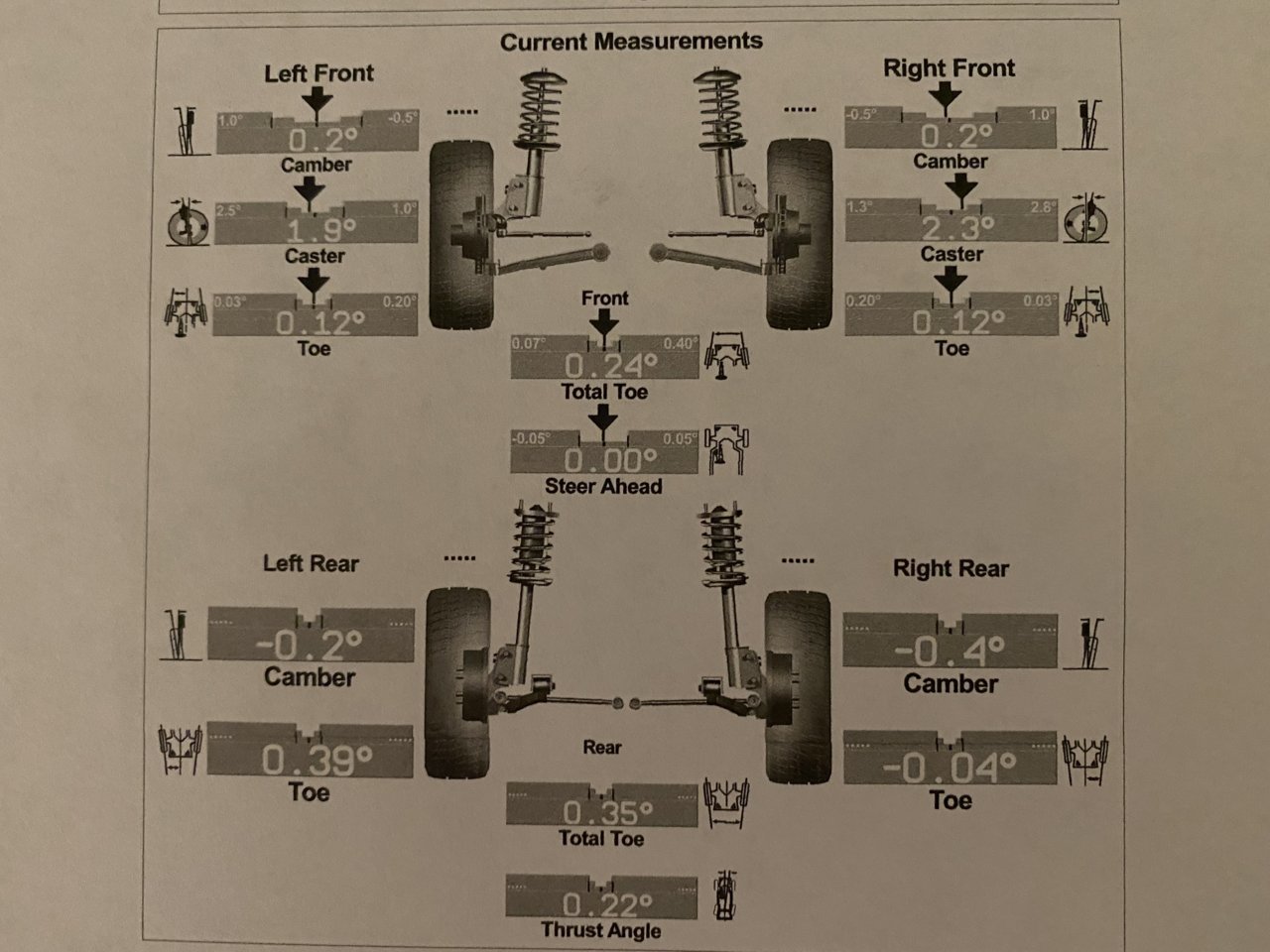

    if this is on the pickup in your sig, a 2020, you should NOT require new uppers with a lift of 3" and less, to get a good alignment.
    im in a 2019 and have a 3/1 readylift with stock uppers. see my alignment below. just had this done on 8/24.
    very happy w/ my #'s

    Awesome post, thank you for sharing. I thought the same from research I’ve done on here. I may get a second opinion on the alignment before purchasing uca’s.
