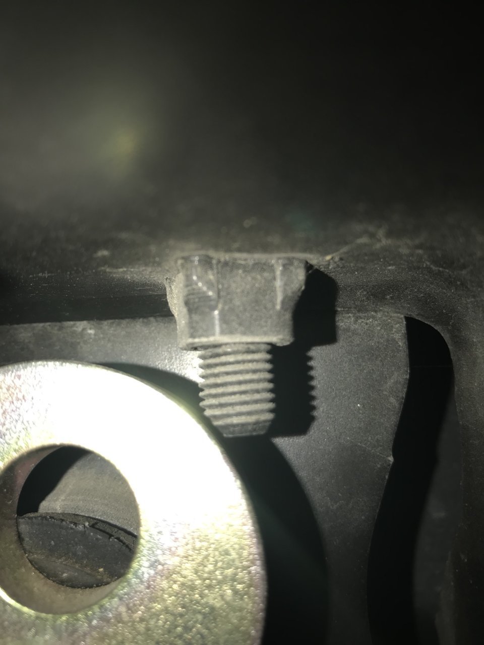

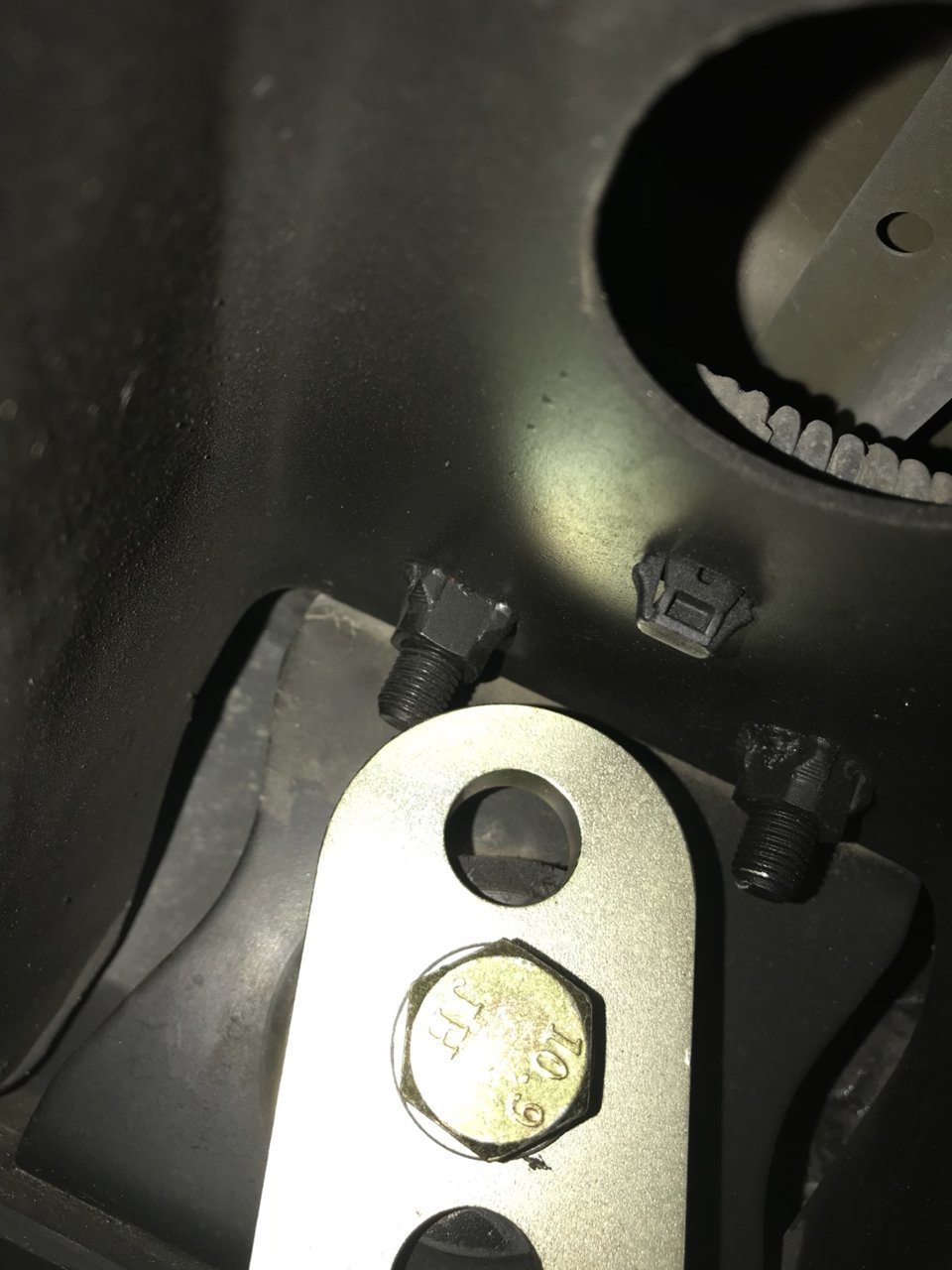

    Some members do have rubbing (listed right under the description details on the site) on the bed bolts if set at the 1 inch setting with the Toytecs. The spring bushings are optional (when adding to cart) if you just want the shackles themselves.

    Does anyone have a picture of the grinded bolt? I really like to see how evasive this process is.

    146
    IS it that bolt on the top right? It looks like it can be hit by the shackle during articulation.

    No....look above the shackle...its one of the bed bolts.

    That looks to be a pain in the ass to grind. To fit a grinder in there.
    Can that bolt be removed from top to be grinded and reinstalled?

    It is a pain in the ass which makes it even more annoying Toytec doesn’t fix it during the manufacturing process.

    lol. The shackle hitting the bed bolt is literally a 2 minute fix and only happens with the shackle in the 1” lift position. It is not that big of a deal. It also does not hinder performance or integrity what so ever. It just makes a minor squeak. If you can’t spend 2 mins cutting 1/8” off a bolt then you probably shouldn’t be modifying any vehicle.

    When I did mine they didn’t have a warning on their website. I found out when it started squeaking, had to take it all apart and fix it. Definitely not a 2 min job in that case. The point is Toytec should fix it instead of letting their customers deal with it.

    This^^^^^^^^ (trimming the shackle a bit is pretty quick. piece of pie.)

    Invest in a dremel. Was able to cut the bolt without even jacking the truck up.

    We have addressed that issue with the body bolt issue by slimming down the shackle itself. It doesn't take long IF it does rub to fix the issue. But then again, I understand why people want a full "bolt in" application overall.
