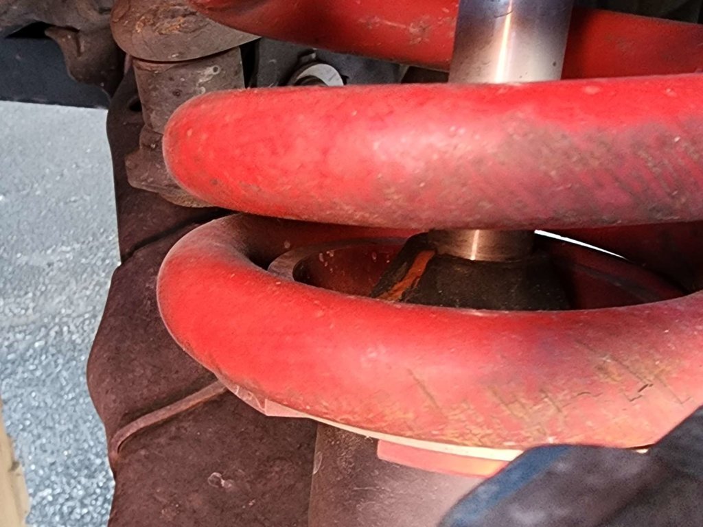

    Has anyone seen this before? This is the bottom end of the passenger side that is split. They are Toytec Alumas with about 60K miles on them. I saw it when I was replacing the SPC ball joints. @memario1214 any thoughts?

    That the built in jounce bumper?

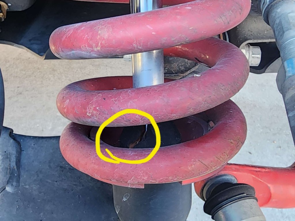

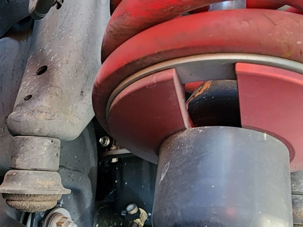

    Better pics. Sent them over to Toytec today and they will take a look at them.

    Is that part of the aluminum lower coil pocket? Or just the bushing itself?

    The bushing.

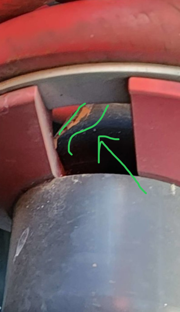

    If you’re talking about this part outlined in green, I think that’s a built in jounce bumper.

    Thanks. It's basically a bump stop?

    Im not the authority on Toytec shocks, so I’ll defer that to an expert, but many shocks have these jounce bumper on the shock body to prevent bottoming the shock out and ruining the internal seals. It looks like a jounce bumper to me. If they sell the parts to rehab these shocks, you can likely buy a new one and rebuild the shock with it. How old are these? 60k miles is a middle of the pack run for a shock. Most won’t live past 80k anyway. Might be time to replace or upgrade.

    Yep basically a bushing bump stop. Easily replaceable.

    If you need to just replace that jounce bumper your best bet is to contact Elka directly.

    They just emailed back and said It's just a bump stop so you can remove it since the truck has bump stops on it.

    That's true, you could add a Perry part bump/Duro bump as an upgrade.

    While "true" that the truck has bumpstops, I can't say I completely buy that pulling them is just fine. My thought is why would Elka spend the money on it if there were no need? :notsure: I don't know any of the dimensions of those particular shocks, but there's a chance that the collapsed length of the shocks currently on the truck are longer than full engagement point of the OE bumpstop which would mean that your OEM bumpstops wouldn't have been making contact since you put on those shocks. However, if what I proposed were true, and you pulled that inline bump, you would be bottoming out the shock on every up-stroke. In a perfect world, the OE bumpstop and in-line bumpstop would reach full compression at the exact same point (both of which are before the shock bottoms out), but I find that REEEAAAALLLLYYYY hard to believe :rofl:.
    It could be perfectly fine, but just playing devil's advocate :devil:
