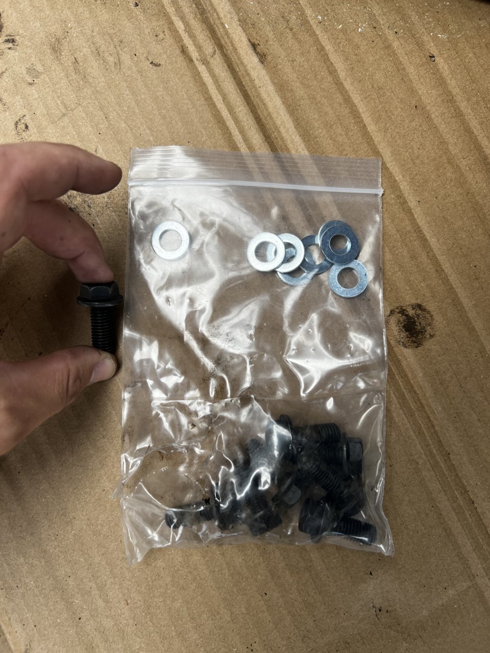

    Installing these bad boys on my 2020 tundra. The coil over came with these steel washers along with the bolts that’s already have washers type heads on them. Any idea what these are for?

    Those are called flange bolts and sometimes washers are used to increase the surface area of the clamping force.

    Yes, mine has the washers installed under the heads.

    Okay thanks guys. Adding them now.

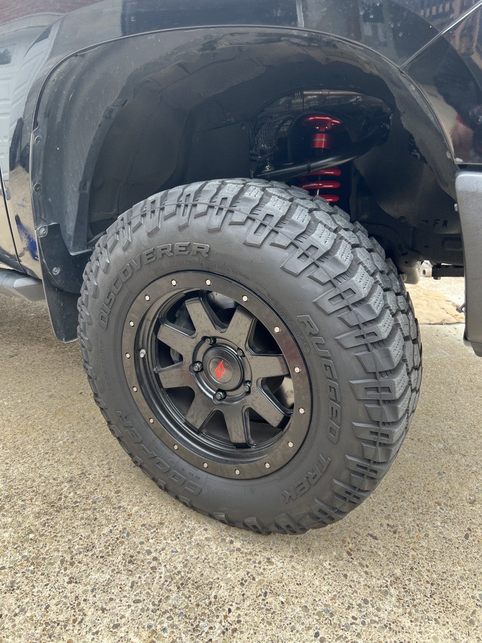

    First side done. Toytec aluma coilovers with SPC upper control arms. Almost done with the drivers side. Can’t thank you guys enough. Would probably never be able to do these types of things without the support of this site.

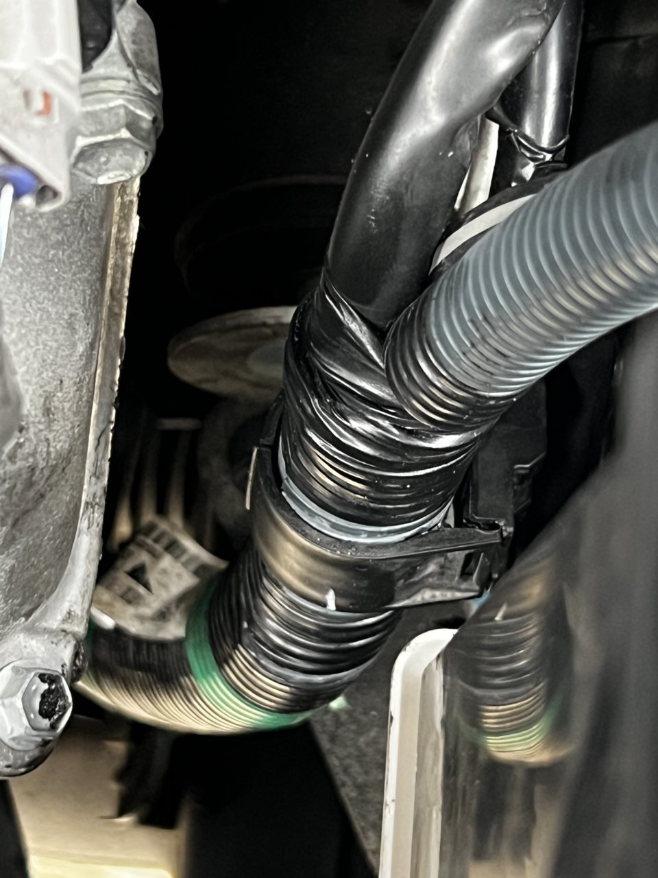

    Okay one more small issue. Drivers side UCA bolt. How do I get this clip off from around this group of wires in order to sneak the bolt by? The passenger side had slightly different clips.

    If i recall its attached to that bracket. See that silver bracket just below it? Go from the bottom and unbolt it from the frame. That will allow you to move it enough to get the bolt out.

    Ahh got it. Hidden just under the battery. Thank you.
