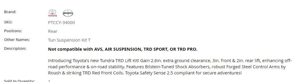

    Thanks for your reply. The Toyota part for their 3" lift package is PTCCY-34000, and retails for around $3100. Not low budget blocks and spacers. Its a fully integrated lift package from Toyota. Still hoping a few members here may have purchased this in the past and can provide feedback.

    That is only for the new 3rd gen Tundra. Not sure how they will fit that your 2010 but do your research and it it makes sense, press forward.

    That's correct; my 2010 Tundra is being retired. The kit would go onto a new 2023 or 2024 Tundra dbl-cab rather than a crewmax. The Toyota lift package seems the best way to achieve the suspension benefits of the TRD-PRO in a dbl-cab configuration, and at a cost far below that of the PRO. I know the cost of the kit, but am still trying to pin down the cost of having the dealer install the package on a new truck.
