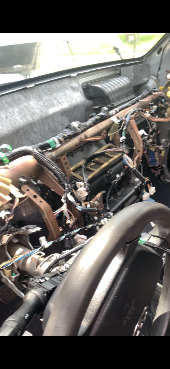

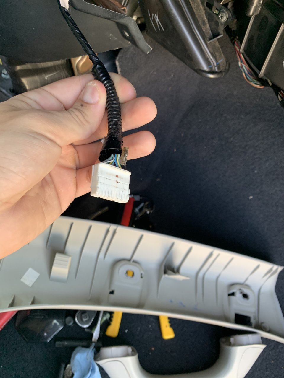

    I changed evaporator but have the one plug left shown in pic to connect and couldn’t find anywhere so am praying it’s for the transponder ecu module on back of hvac box and that I missed.
    been trying to get struck to start for a week and couldn’t find issue.
    Truck has no security light flashing at all so I think/hope it’s because the transponder ecu module wasn’t plugged in.
    Took dash out 3 times already and couldn’t find anything not connected so with gods good will hopefully that plug isn’t connected and the truck will fire right up when I connect it.
    gonna do it this afternoon and post here of it worked!
    if you happen to know which side of hvac box it’s on Id really appreciate it so that maybe I don’t even have to remove dashboard again

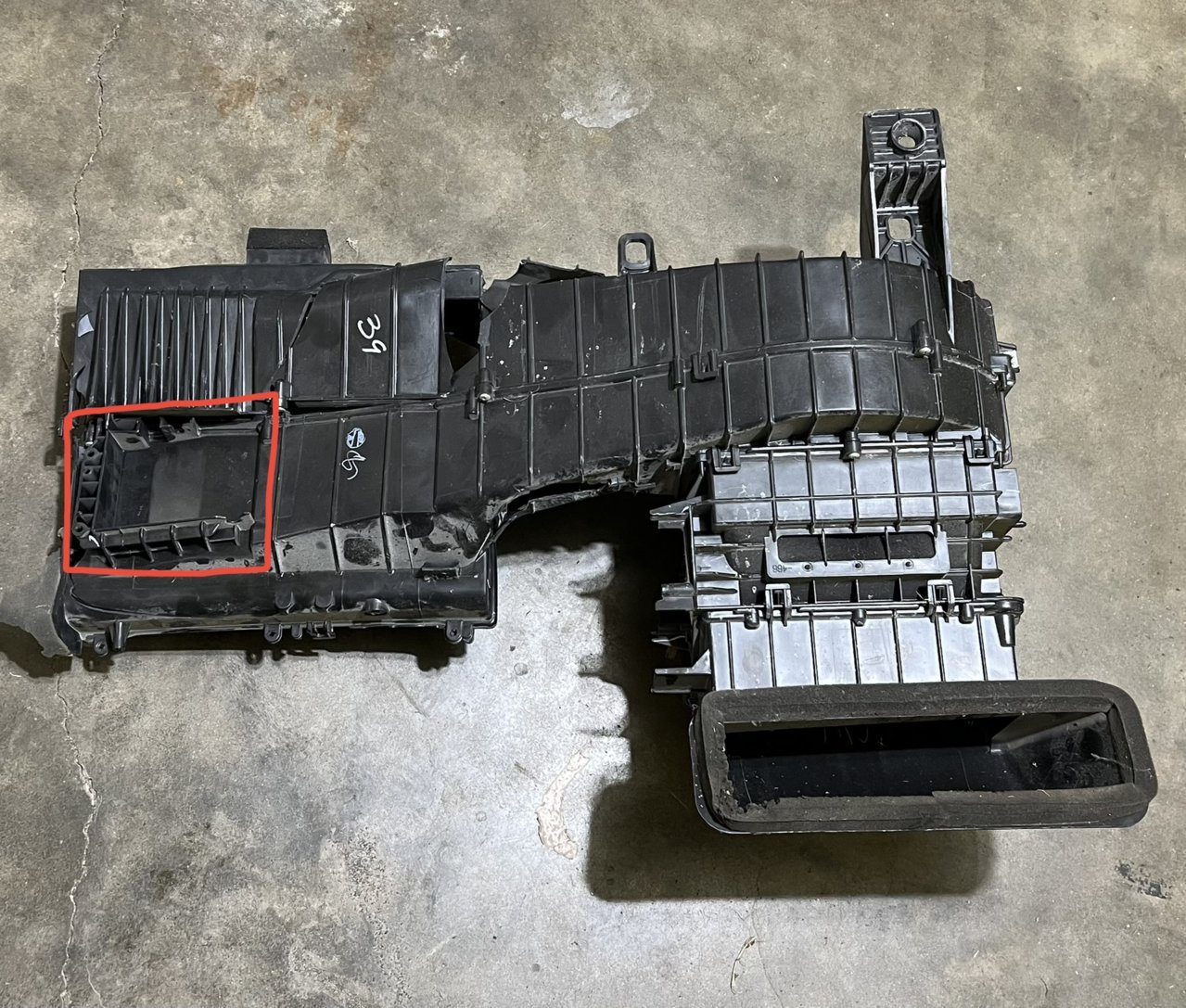

    The Transponder ECU is on the back of the HVAC box near the fire wall in this cut out area (in red). Looks like to me the connector comes in from the passenger side and its up near the top of the box. Study yours carefull as this picture is kind of upside down from the way the box sits in the truck

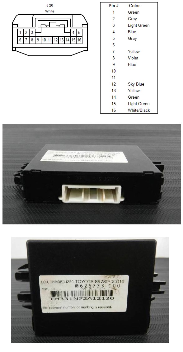

    Look at this pinout to see if your wire colors match. It most likely is the Transponder ECU plug from what I can see.

    it’s exactly what the issue was, causing the crank no start & no security light flashing. after changing evaporator and putting dash back, didn’t see that connecter there for the transponder ecu and didn’t plug it in.

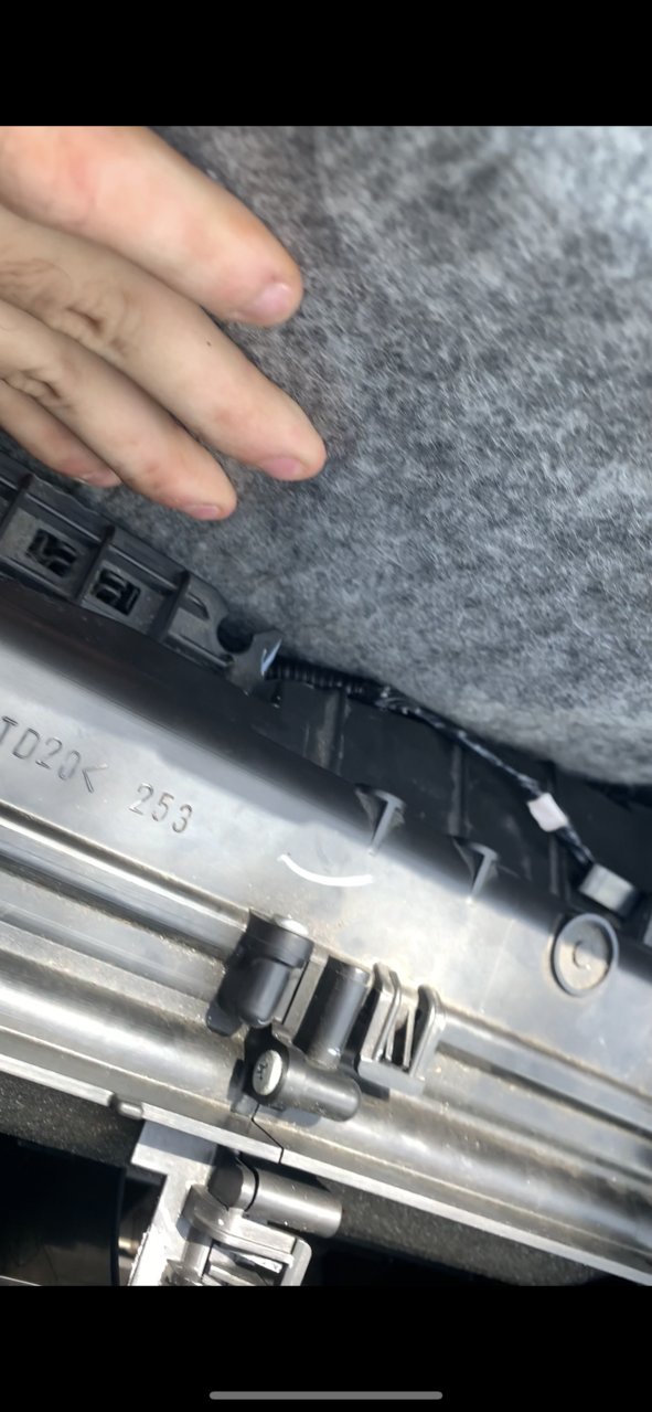

    but this is pic of the connector back there
