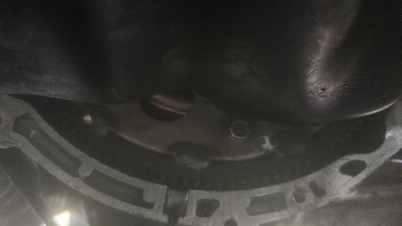

    Hello I replaced my 3.4 2003 toyota tundra transmission. The transmission is making a grinding scraping noise near the torque converter. The torque converter bolts were torque to 30 ft lbs. Anyone know what could be the cause. Transmission fluid has been filled

    The flex plate looked fine

    Can you see see anything shiny where things might be rubbing?

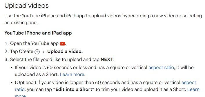

    What format are you using to upload the Vid?

    So the scratching noise was coming from the tail which was slight bent and coming from the shaft but. I have the car lifted and now when I accelerate in Drive or reverse it doesn’t make any noise but when I press the break it makes the noise coming from the bell housing. The video format I’m using is from my phone. I have an iphone

    You have to upload your video to YouTube (or Facebook, or Vimeo) then link it here
