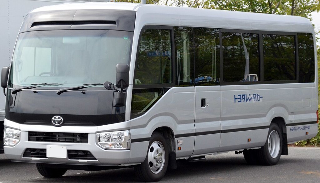

    I want to get out of some didactic doubts, I don't know how many generations there are or is it the same but the drought and tundra some come with a 10.5 differential this is hard but not as resistant at the ends, maximum 2000 pounds and some series 70 come with a 9.5 floating differential but they resist according to the Toyota 2900 pounds, my personal opinion they resist without forcing it between 2900 and 3100, how many pounds could a 10.5 '' move by modifying its ends and some other improvement? What size is the Toyota Coaster annular gear? I searched and searched, I found its tooth pitch only, no sizes and through other research I found that its maximum weight would be 4000 pounds, it is floating. The Dana 70s are 10.5 and easily move at least double that, 8,000 pounds. My idea for a Toyota Coaster differential would be to compare it in size to a Dana 70, but according to Toyota, it would only be 4,000 pounds, and I'm missing another 4,000.
    ? So, should the ring gear be smaller, or not? A 10.5 Tundra with floating axles should easily move 10,000 pounds, obviously with a good engine that can move that weight. What I'm trying to get at with this is that I'm doing a study on the maximum weights supported without the material suffering too much and its cost being feasible, and I'm interested in Toyota mechanics.

    According to a Hino employee (they manufacture the axle), the actual design GAWR for the 10.5” axle is about 5500 lbs. For anyone that has disassembled one of these, it’s fairly easy to surmise, based on component size, that the supplied number is well within the realm of what it can carry.
    Coasters have a similar 10.5” differential (same diff to housing gasket), but the axle spline count is different. Coasters with the 10.5” are rated for a max gross vehicle weight of over 12000lbs. They have very heavy FF housings and big hubs.
