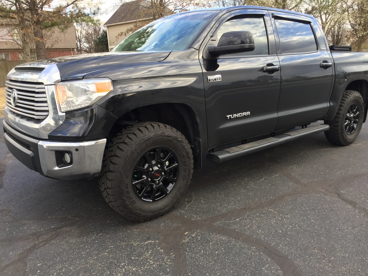

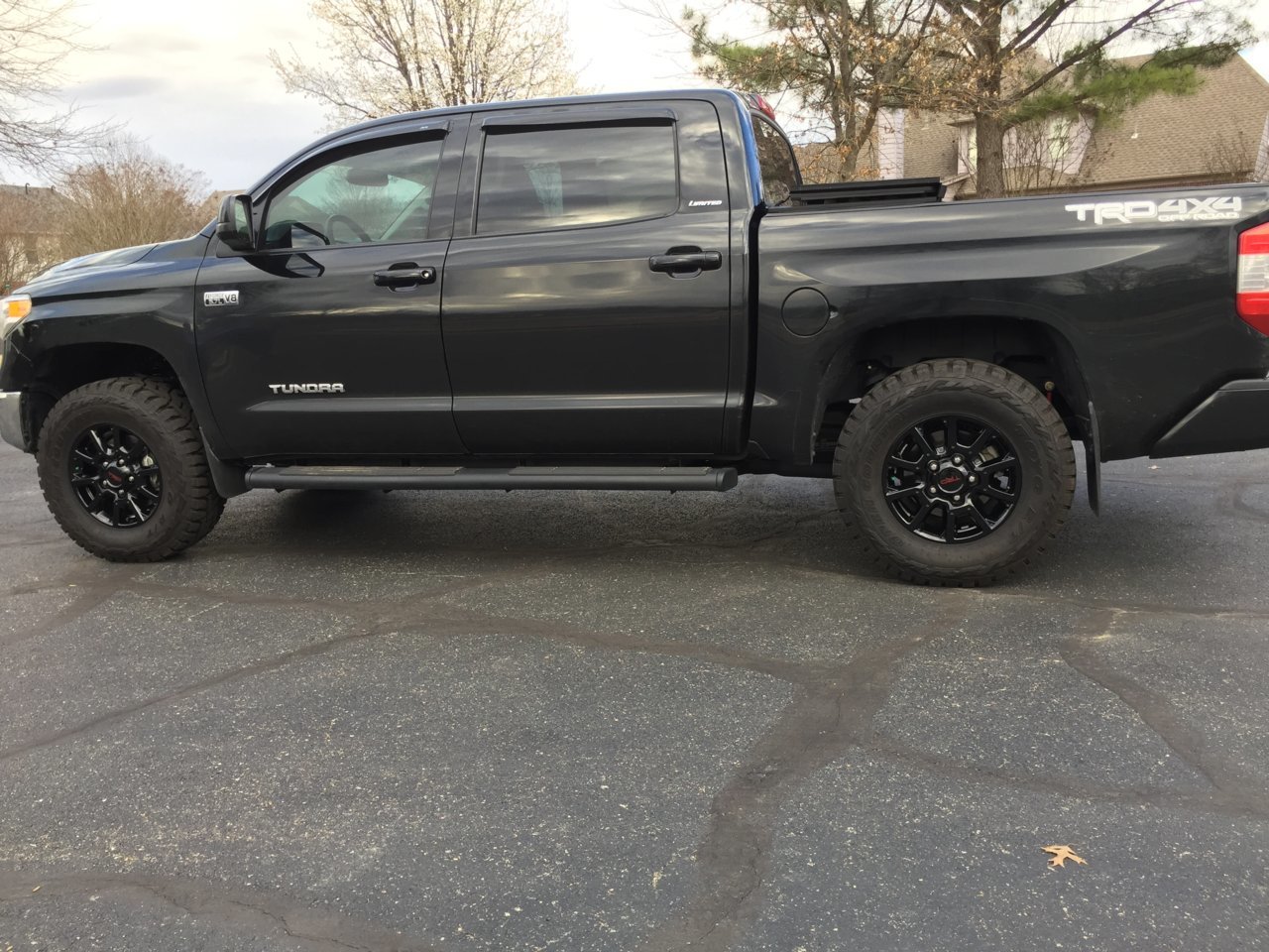

    Installed today and no trimming on liners, removed small mud flap on front of tires. The skid plate is still off as it will need a little trimming.no lift in back yet and not sure if we r going to as its level. tires under full lock to the left rub sway bay slightly- but you have to hold it at full lock-left to do it so no biggy.Pictures later after i figure that out

    Looks awesome!

    Looks great and I am looking at that size tire as well.
    Dumb question, is the TRD front raised some, over a plain/stock SR5?

    This truck isn’t a TRD pro so the suspension is the same height as sr5. We did install bilstein 5100s on the front —set at the highest setting.
