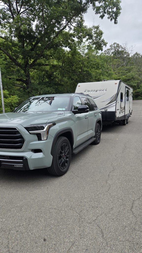

    Im towing about 5k with mine. 24' bunkhouse, so about the same length. Much more power on the highway and up hills than my Crew Cab Sierra 5.3L. BUT you feel the wind a lot more with the shorter wheelbase. Towed last week with a stiff cross wind, and it was white knuckle at times.20250817_172240.jpg
