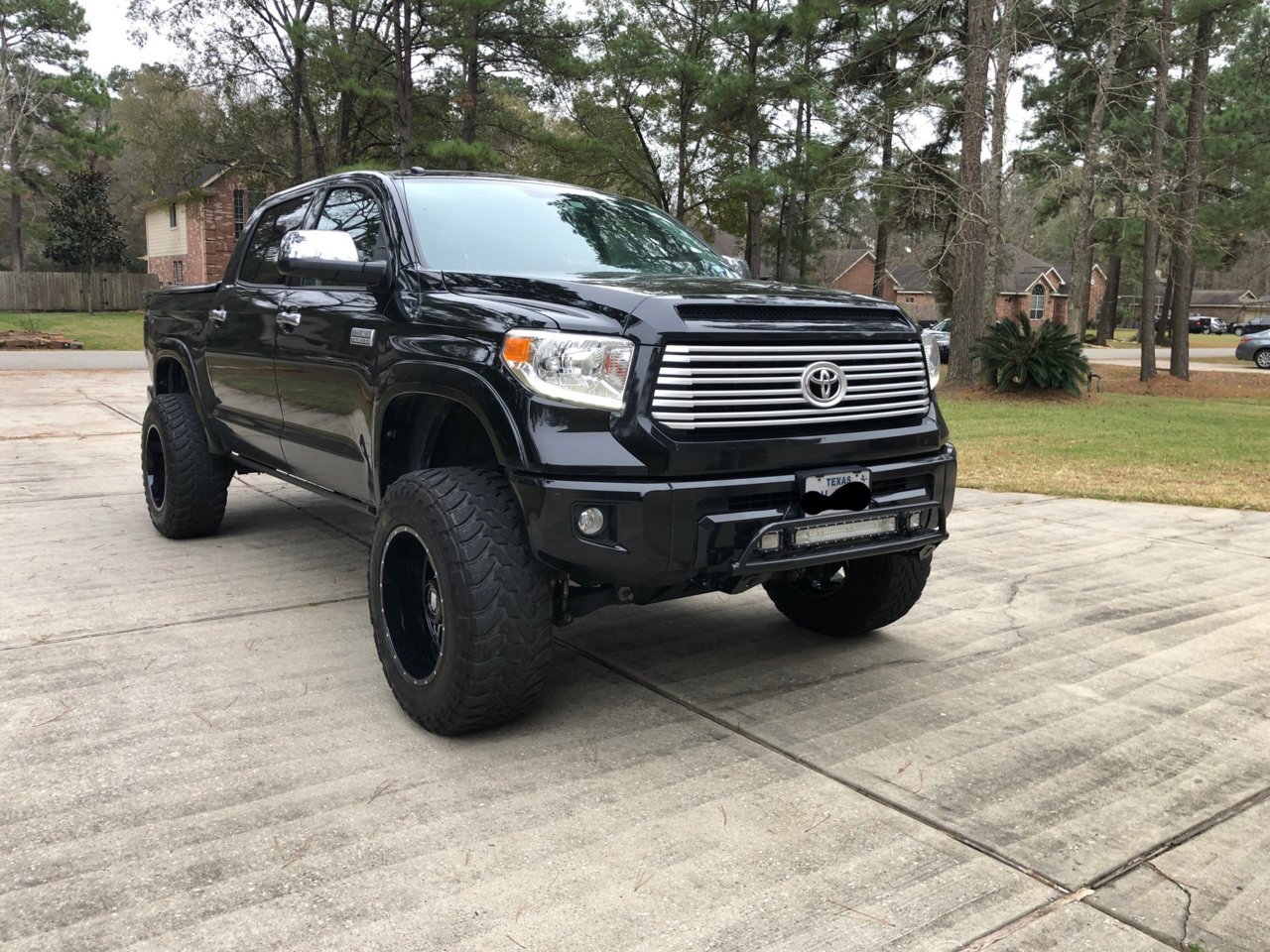

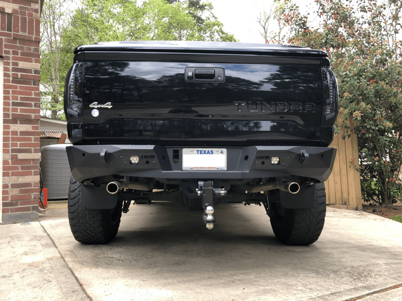

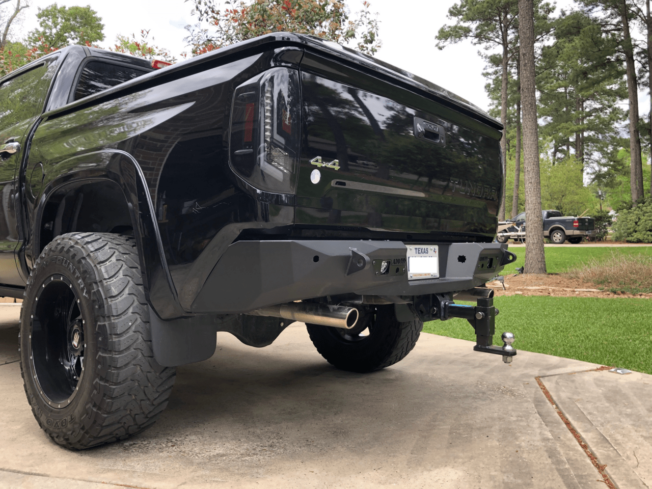

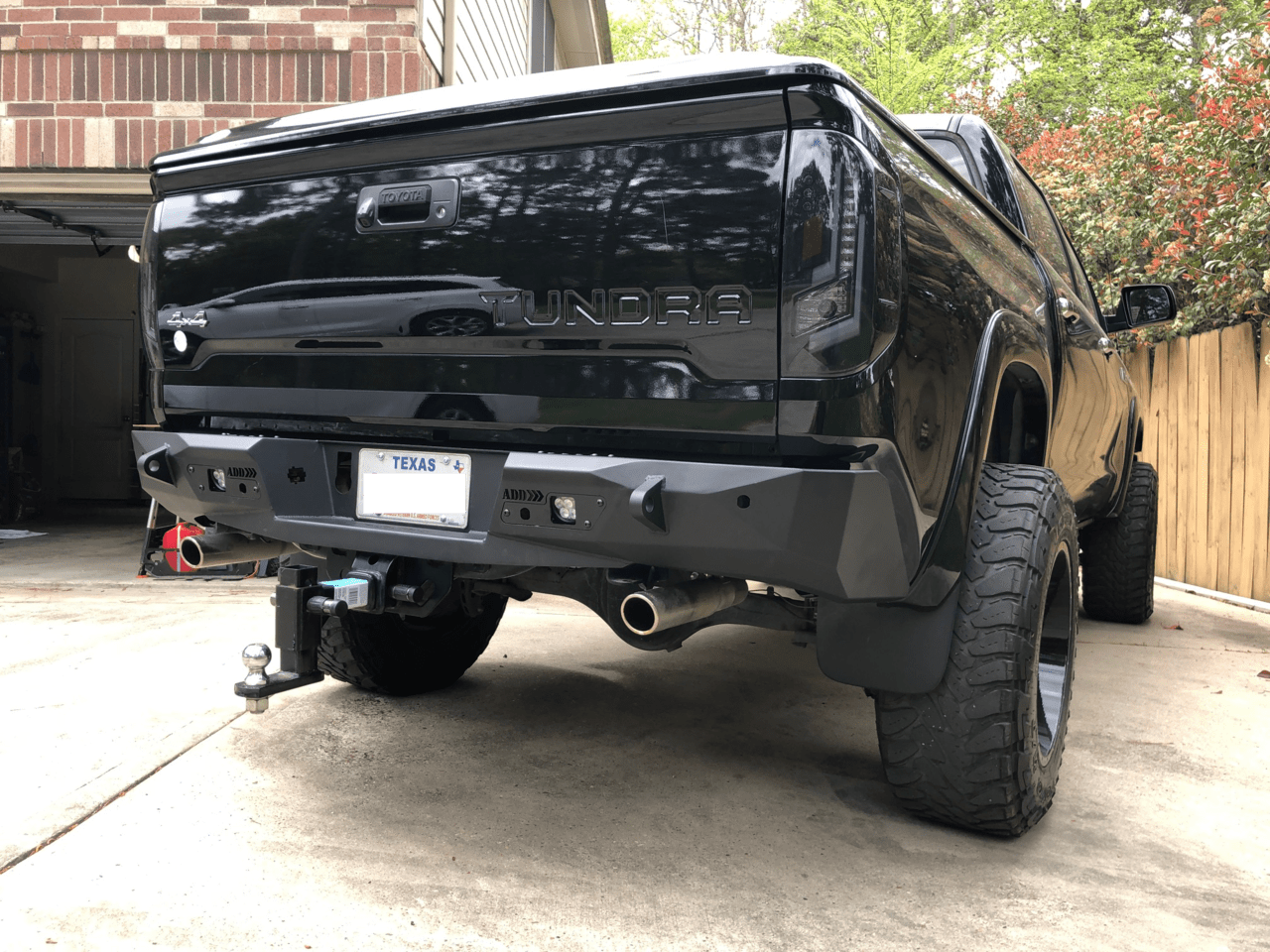

    Still gonna swap the front bumper and may lose the tonneau for a headache rack. Just got the rear bumper on after somebody hit me. Gott finish the sensors, plate lights and reverse pods

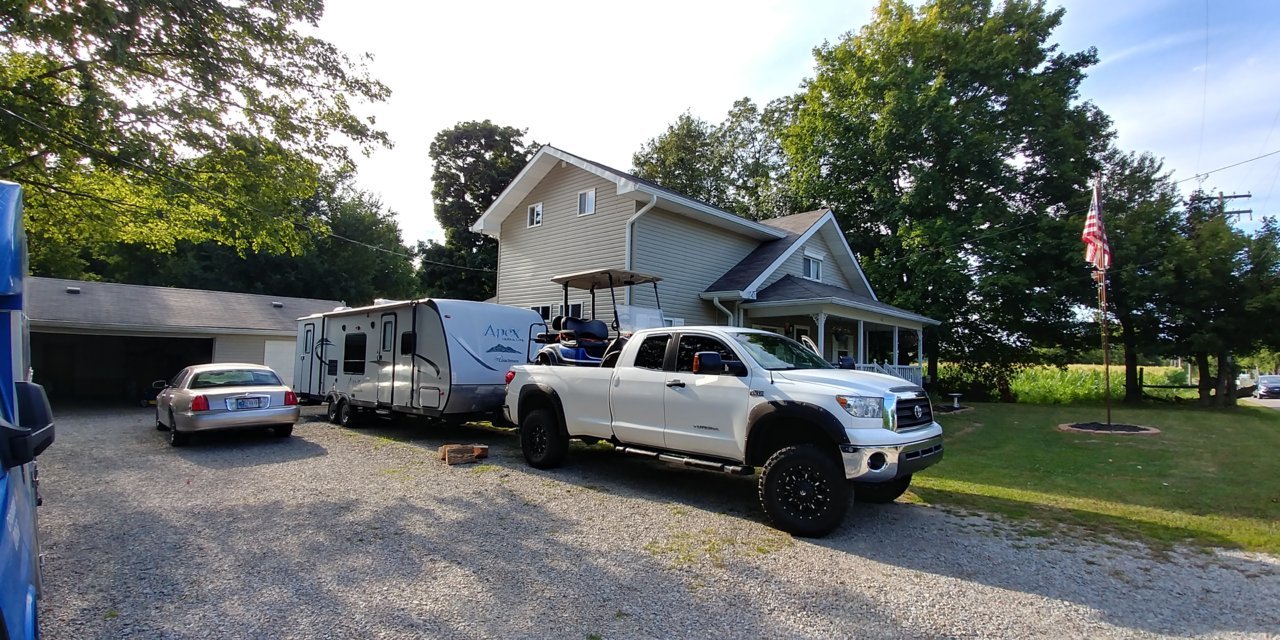

    Idk about 37s but I do it with my 35s bo problems stock gears. Also pulled with a golf cart in the bed. Not to many times and not far. No longer have the cart. Camper is a 28 ' 30 from hitch to rear bumper 20170813_183210_HDR.jpg

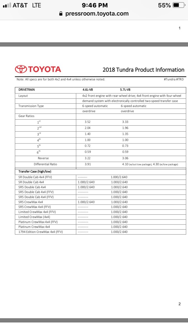

    There are no stock 4.88’s. The towing package has 4.30’s and the non towing package has 4.10’s

    I remember seen 488 on my truck sticker when I brought it. I could be wrong I am going to double check my owner manual
  26. Mar 30, 2019 at 6:49 PM
    #26
    DM 2018 Tundra
    DM 2018 Tundra New Member
    Nov 1, 2018
    #21227
    719
    South Carolina
    2018 Limted Tundra
    6inch RC with upgrade struts. 295/65/20 Nitto Ridge grappers 20x9 fuel vapor with 0 off set
    Yeap ur right! Sorry. 488 must have been on my F450. 492474DB-7D03-4F7D-8C54-027576213776.jpg
