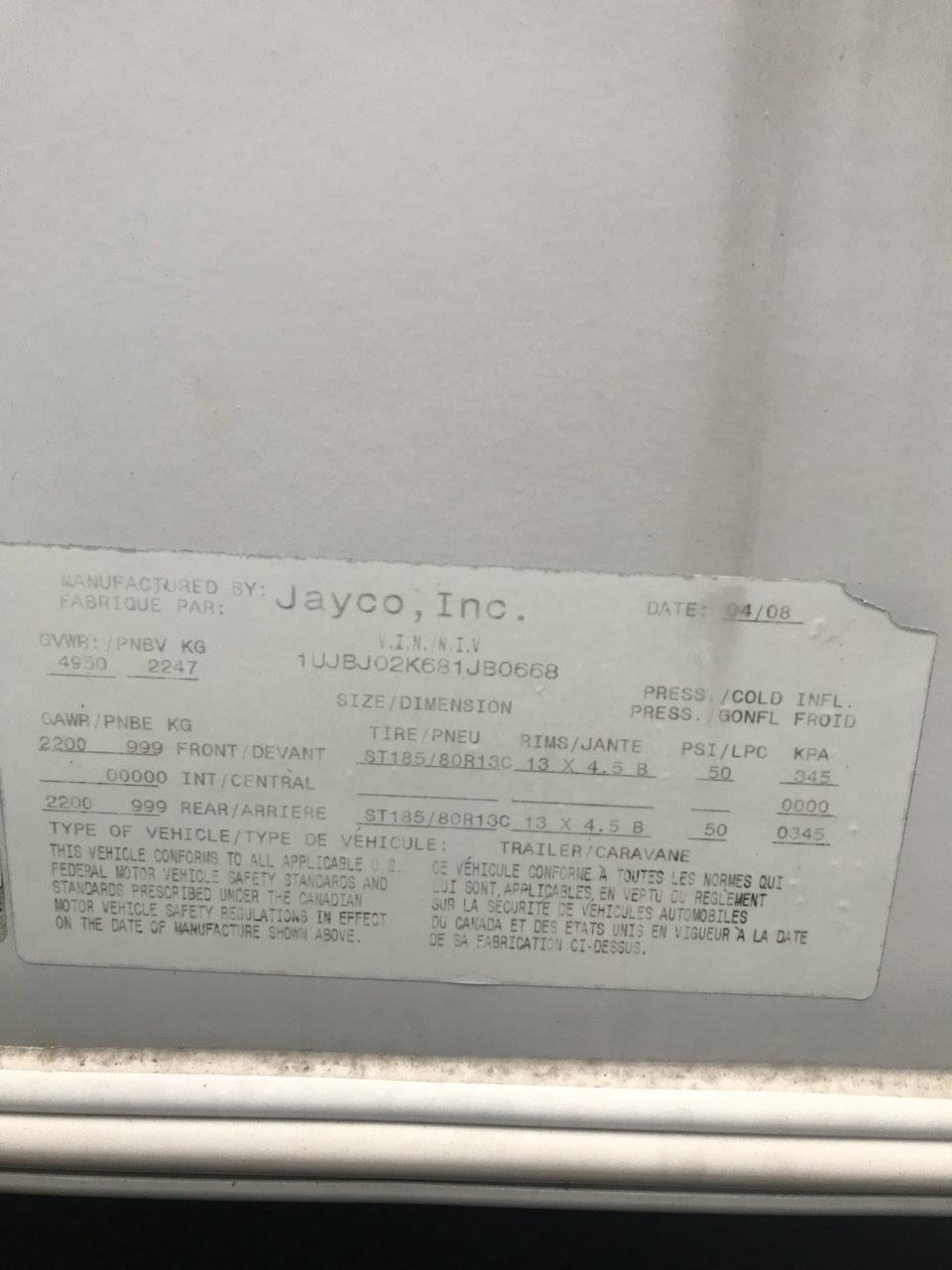

    These are the specs for our new to us travel trailer that we are taking out next week to raystown lake. It’s our maiden voyage. Previous owner bought it, let it sit, the water line froze and burst and flooded the back end. About half the floor was rotted. NOTHING has ever been used in it. I offered the dealer 4500 and they took it after it sat on the lot for 8 months. I spent a weekend ripping out the floor and laying a new one. It’s absolutely like new now.
    Anyway, any advice on what to expect with towing this rolling brick is appreciated. I have the built in trailer brake And a weight distributing hitch. I have towed utility trailers and pop ups for years.....but this is a new animal. Spec states 4950 lbs GWVR

    Make sure your trailer brakes are adjusted properly on the trailer and that your brake controller is adjusted properly. This will make the difference between white knuckle emergency stopping and stopping with confidence. When I bought my new camoer I had to set my brake co troller gain to 10, and it wouldnt even lock up the trailer brakes. Never assume that the trailer brakes are properly adjusted from the factory!

    Yep, I have them set. Did that at the dealer before heading home. It is set at 8 right now. But will test again after installing the WDH

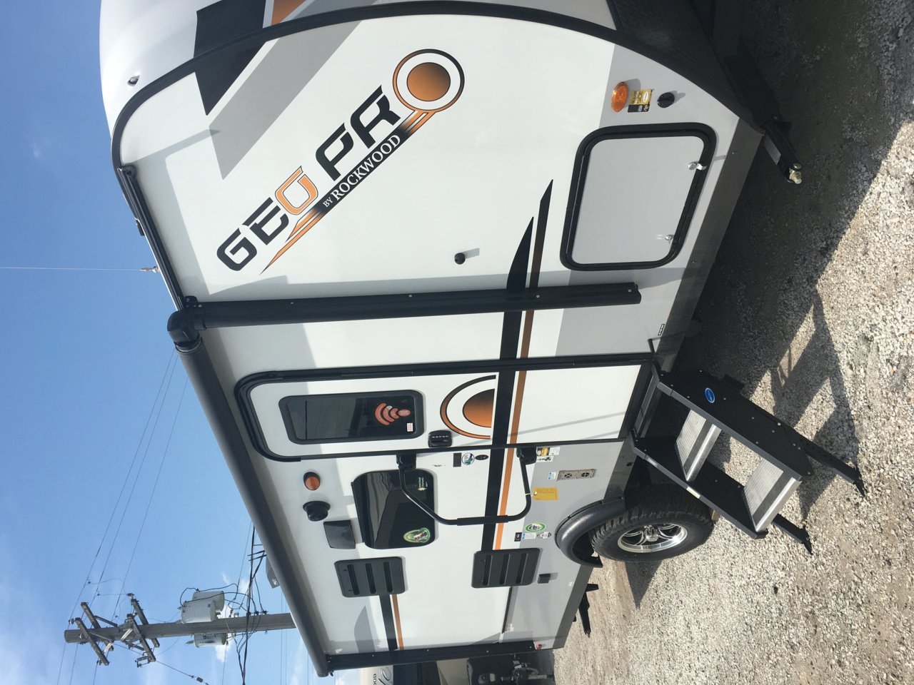

    I'm also going to be a TT newbie! Looking at getting a Rockwood Geo Pro! I'm going to be getting a P2 and a WDH. Hitch weight is 455 and dry weight (UVW) is 3,513.
    @ColoradoTJ I've always appreciated your knowledge. Any suggestions for me in the new experience? Driving to Omaha to pick it up. I'm looking at getting a Husky WDH. Anything I can do and learn to be safe for my family and others on the road? I will be browsing a few of the tow threads as well.

    That is a nice camper.
    With that size of camper, you will not have any issues towing.
    Did you have any specific questions? More RV related?
    JC303[QUOTED] likes this.

    21 ft long and 7.4 ft wide. Do you think tow mirrors are needed? Any concerns towing a trailer that size with 35s? I would like to re-gear some day to make life easier on the trans. Will wood do a good job for leveling and stabilizing jacks or are the blocks the way to go? Really any advice for a beginner. Going for a 2 week plus road trip in July. I will do a dry run close by before the long trip. Any necessary cleaners for black tank?
    The wife and I have been waiting for this moment. Life is short so why not have fun! Sorry for all my Newb questions and concerns. I over think everything.

    I really like tow mirrors with anything enclosed or longer than 16’. This is just my preference.
    Get a set of walkie talkies for maneuvering in RV parks or remote camping. Trust me, it helps when backing up. I ran my RV into a tree branch and did some damage. It was a stupid mistake and I knew better. To cheap to spend 40.00 on a set.
    Towing on 35’s shouldn’t be bad. As always, any Tundras.com member in CO has my blessing to try out one of my trailers. My new 20’ flatbed is 3600 lbs empty, if you want to try it out.
    To my point on trying out the trailer, if the transmission is constantly hunting for gears, time to go to S mode and hold gears.
    Wood will work. The less you extend the jacks, the more stable the camper will be.
    Definitely bring black tank odor pods. There’s also chemicals that help break down solids. If you ever plan on going to an RV park or state park, fill up your black water tank 1/2 full and put some dawn down the crapper. Then tow to location. The sloshing around cleans tanks, sensors, and keeps everything working properly.
