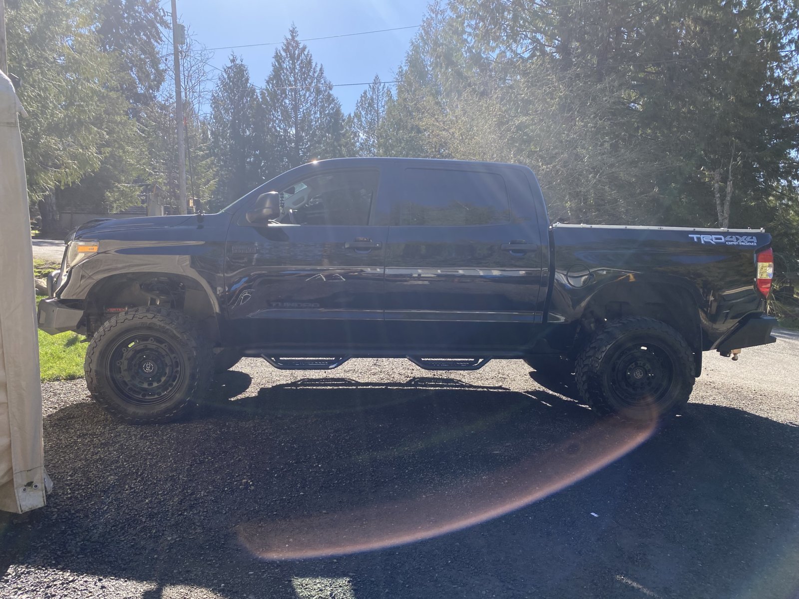

    I am a 1st time travel trailer (28’) owner. Curious what kind of suggestions or opinions everyone has regarding rear leaf springs/air bags/etc.
    I’ve been trying to “get educated” and just joined this forum to get some advice/criticism.
    Go easy on me if I ask any stupid questions!

    Welcome. I'm a big fan of Roadmaster Active Suspension HD. It acts like a rear sway bar and, depending on how you dial it in, supports a large portion of your available payload without sagging. Not sure what your tongue weight is with that setup. Have you weighed your rig at a CAT scale?
    PS: I did not like air bags at all. Some people dig sumos. I don't have any experience with those.

    @JMGmanAZ @bflooks @Terndrerrr I am relieved to hear you mentioning the Roadmaster Active Suspension HD. I have been shopping around and these seemed to be a great addition. I was contemplating on adding a higher numbered leaf spring or researching that option so thank you for sharing that. I have not weighed my truck on a CAT scale. There is one about 25 minutes from me so I will go this weekend. I did however go pick up some bark yesterday with my 3 boys and we were sitting at 6940 prior to adding bark.
    This part may sound dumb. Tongue weight... Before I attempt to explain what I have going on- The gentleman I bought the trailer from also included the WDH that was on his F350. I left those components with the trailer itself so should I be looking at the specs on it? I do believe it was a Class 4. Is tongue weight something I should focus on only on that WDH or the truck? (AGAIN, sorry for stupid questions)
