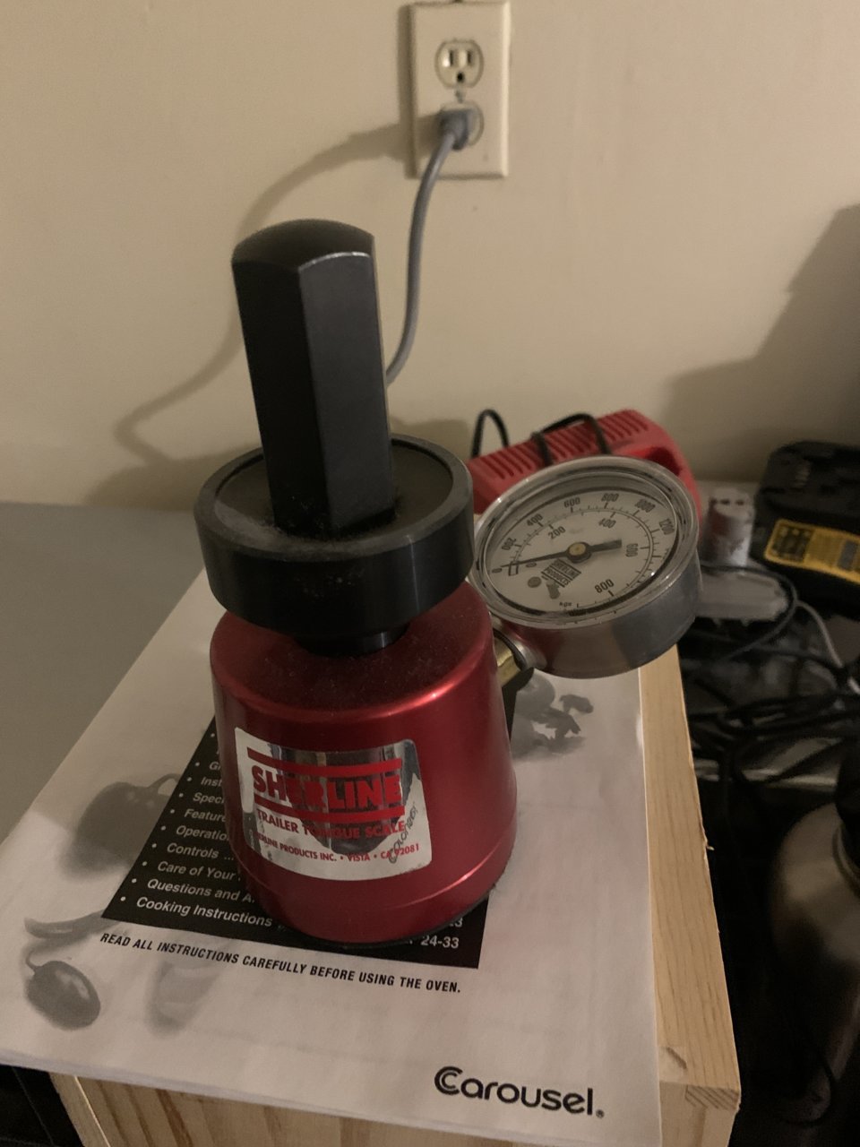

    You can buy tongue weight scales. Should be some recommendations in other threads here.

  12. Jun 6, 2021 at 5:12 PM
    ezdog
    ezdog New Member
    Mar 1, 2020
    #43363
    2,683
    Gateway To The West
    2001 RCLB V8,4WD 2015 RCLB 5.7,4WD
