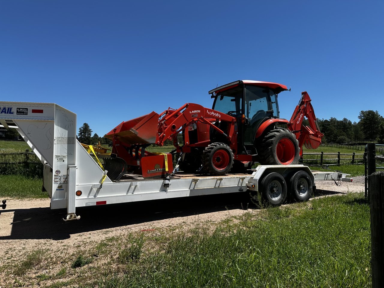

    I will say this, towing whatever will be easier in FL than other places in the US. Towing the weight you are looking at is definitely not a good idea.

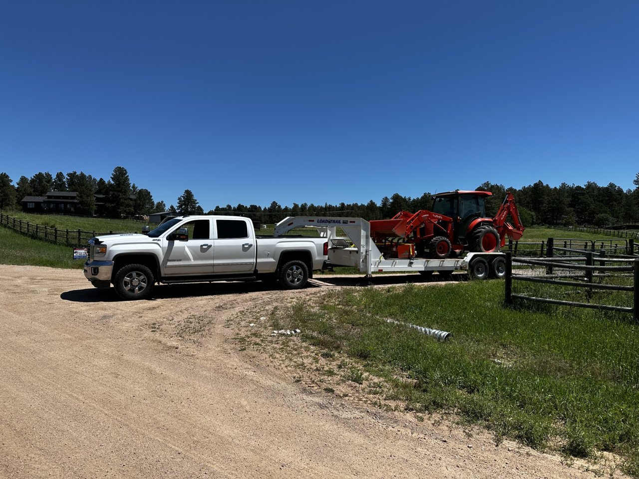

    Here is for reference. The trailer weighs 4600 lbs. Tractor with all implements together is 10000 lbs. I felt this weight. That is a 1 ton diesel that is far from stock.
    Personally, I would rent the biggest trailer you can for a weekend and see how the truck does.
