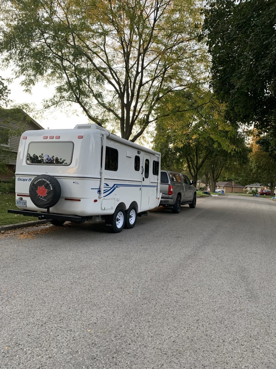

    The Tundra tows my trailer (19’ at 3500lbs) like it’s not even there. One thing I will mention though, consider where your going. My 4Runner towed my 17’ trailer really well around the Great Lakes at 800’ but west of Denver, I was in 4th and 3rd. For every 1000’ you lose 3% horsepower. At 11,000’ my 4Runner’s 278Hp was down to 180Hp. Not enough for the Ike.

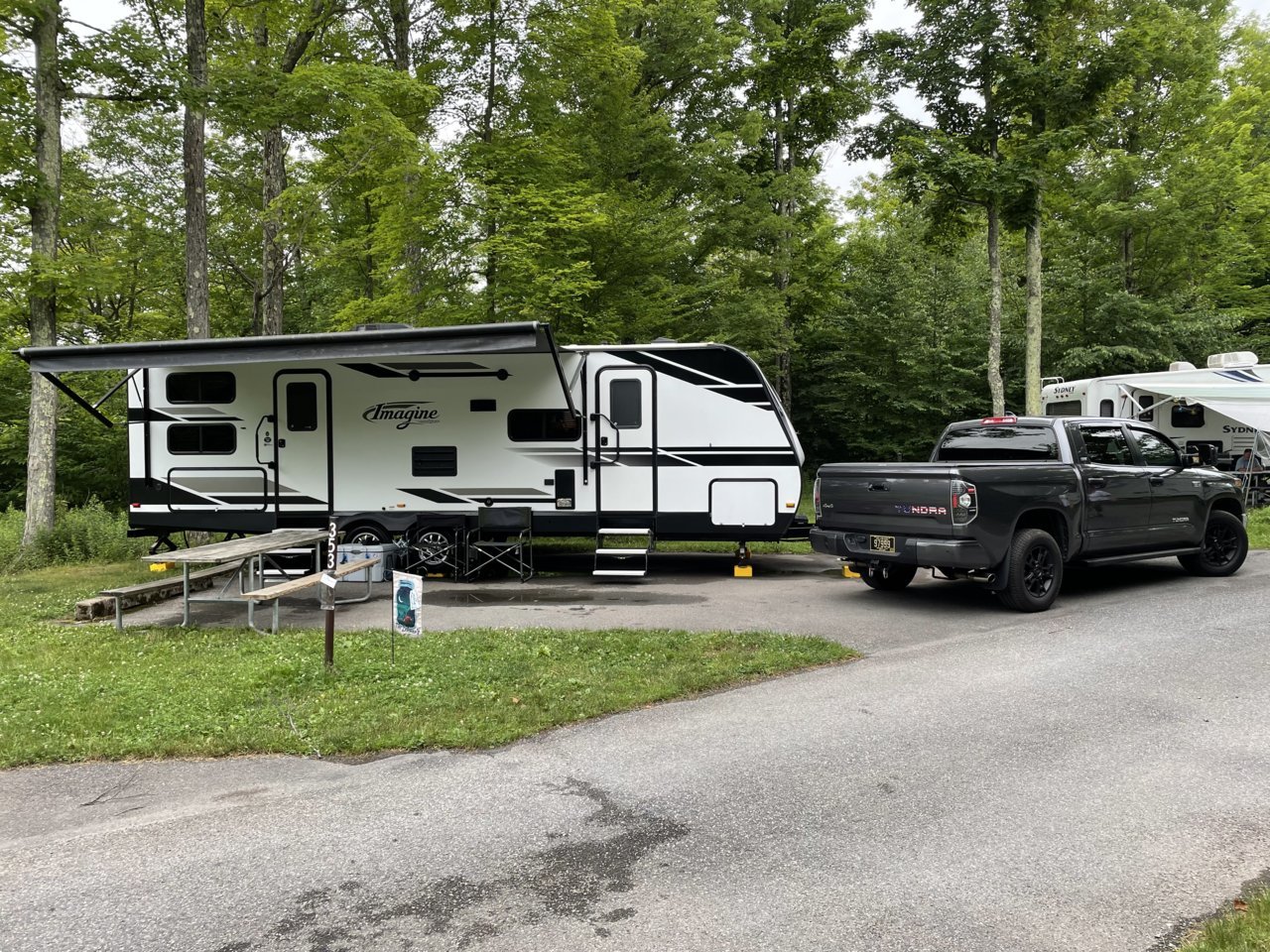

    I tow a 2800 BH Grand Design. It weighs in at around 6700 #’s with all my regalia. I went with the Blu Ox Sway Pro WDH. I did recently replace my stock Michelin’s for Cooper at3 XLT’s. The 10 ply tires are far superior for towing. They helped tremendously. I was a little concerned with the stock tires, but now I feel very comfortable towing our camper. The Tundra handles it just fine. MPG is around 9 when towing.

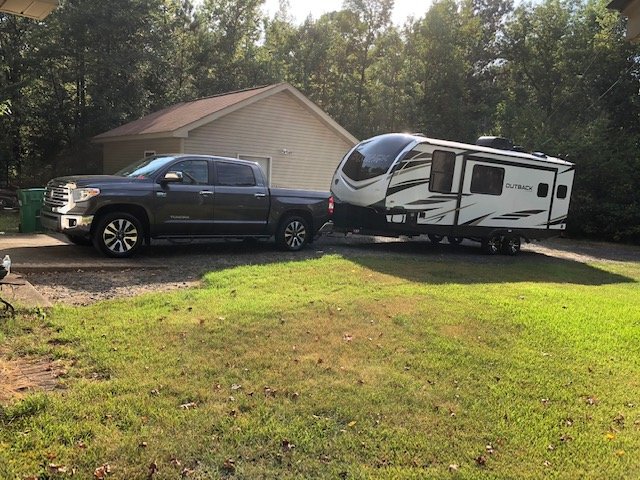

    I bought a 2018 Limited with the 5.7 liter a couple of months ago to pull our approximately 6000-pound travel trailer, and it romps right along with it. I'm very pleased with how it handles the trailer. We use a Fastway E2 weight distribution hitch. So far we haven't had it outside Arkansas, but it handles the long inclines on Hwy 65 in northern Arkansas like a champ.

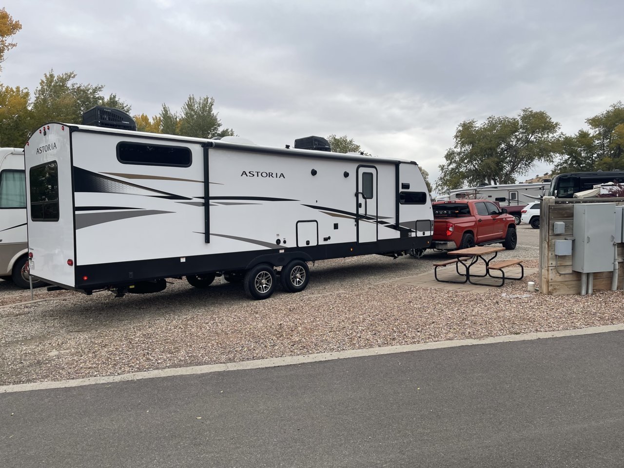

    I just purchased and towed an Astoria travel trailer 7500 dry ,I have a 2017 crew max 2wd and my truck did a really good job considering the weight.Motor never ran out of power .Not the best in mpg's but did the job with reliable toyota power .Transmission was great in tow/haul mode
  14. Oct 24, 2021 at 5:24 PM
    Infernotundra17
    Infernotundra17 2017 Inferno SR5 Crew Max
    Jan 22, 2021
    #57972
    186
    Martin
    Las Vegas, Nevada
    2017 Tundra Inferno orange
    Black Rhino 20" Go Rhino RB20 steps Magnaflow muffler
    Trailer was 31'long
