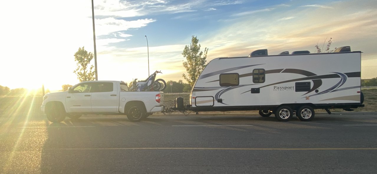

    Trailer dry weight 4300 lbs. 2018 Tundra 5.7L.
    Is it Ok to just use tow haul mode or should I shift down a gear as well?
