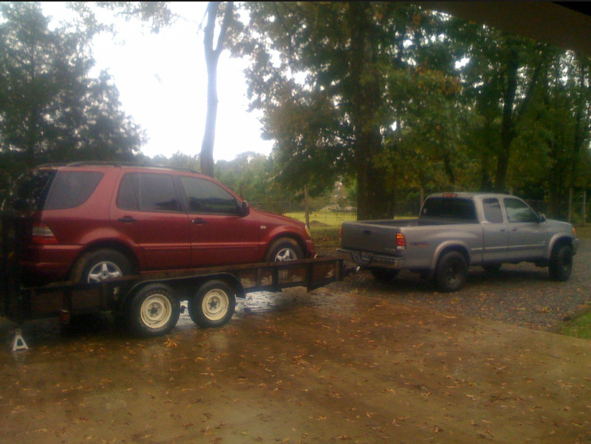

    I mean if a first gen can do it…

    KNABORES,
    That's an impressive picture! I definitely need to get this Tundra into action.....my GMC Canyon struggled a bit to maintain 55 mph pulling my single axle trailer with zero turn and lawn tractor on it up just a slight hill. :(
