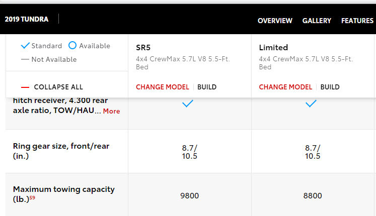

    Here is a chart from Toyota's website.

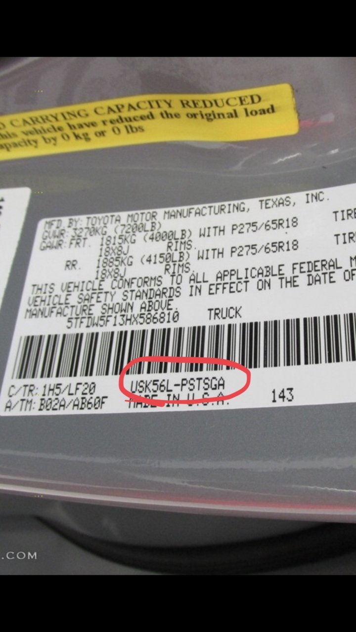

    Take that code match it with your manual in the towing section and it will tell you your towing capacity

    The chart he posted has both crewmax specs. The limited shows 1000 pounds less than the SR5.
