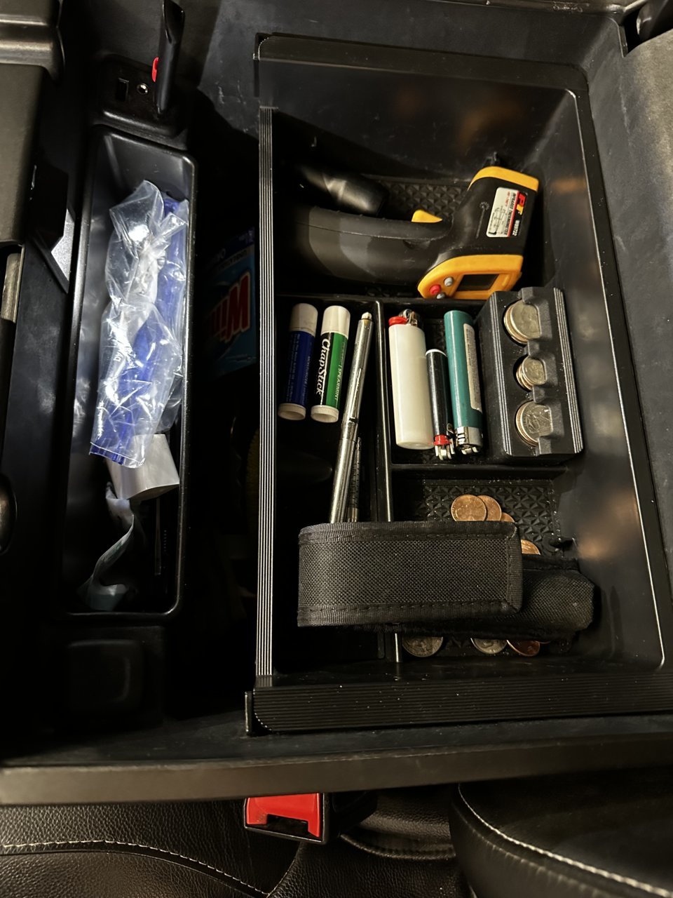

    -At 2000 miles, the drivetrain is probably good to go. If you have a thermal gun, I would take it with you on the first tow, keep speeds a little lower than normal (I keep a thermal gun in the truck at all times). IMG_1601.jpg Pull over after 30 min of towing and check the rear differential housing with the thermal gun to see what kind of temps you are running. If temps are over 180*, I would have a coffee and take a short break to cool things down. If temps are 130-160*F you should be just fine.
